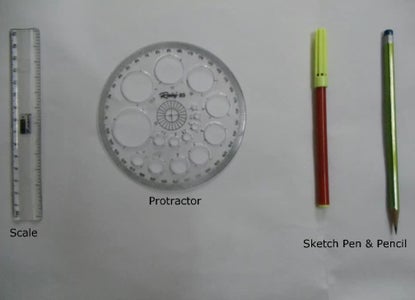

Step 2: Things Required

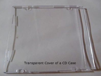

1. Transparent cover of the CD/DVD Case
2. Sketch Pen
3. Pencil
4. Scale
5. Protractor
6. Scissor
7. Knife
8. Super Glue
9. Eraser
10 Thick white paper for template creation

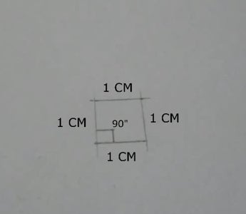

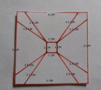

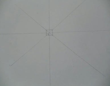

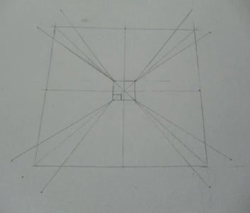

Step 3: Creating Template - Step 1
1st Image - Draw a 1cm x 1cm square

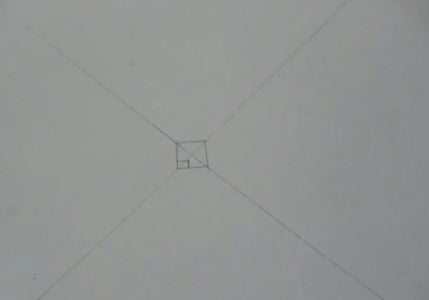

2nd Image - Draw diagonal lines to obtain the center point
3rd Image - After achieving the center point draw a horizontal and vertical line

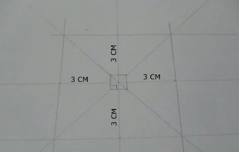

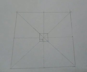

Step 4: Creating Template - Step 2
1st Image - Now measure 3cm from the border of 1cm square on the vertical and horizontal line (from the center point of the 1cm square it should be 3.5cm)
2nd Image - Erase all the external line

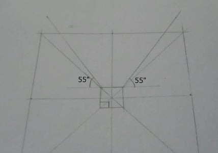

Step 5: Creating Template - Step 3
1st Image : Now Measure 55 degree from the border of the 1cm square.
2nd Image : 55 degree should be made for all the borders of the 1cm square (You should achieve eight 55 degree lines in total )
3rd Image : It shows how it will look after all the 55 degree lines are drawn

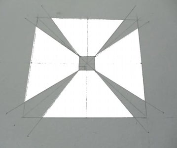

Step 6: Creating Template - Step 4
1st Image : Highlight all the important lines with a marker or a sketch pen
2nd Image & 3rd Image : Now cut the template

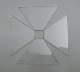

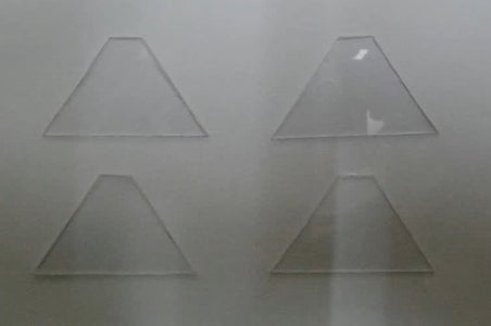

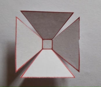

Step 7: Creating Template - Step 5

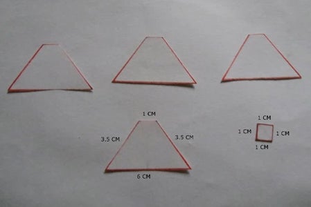

1st Image & 2nd Image : Use the template to cut the pieces on the CD case
Step 8: Joining
1st Image & 2nd Image : Join all the pieces (this is bit difficult step)

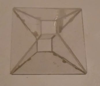

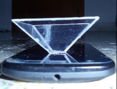

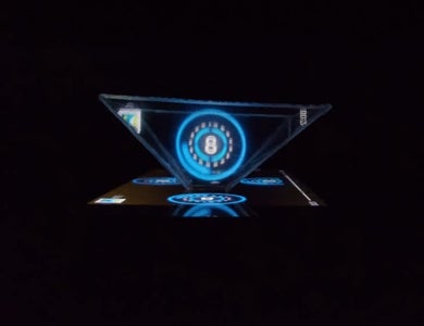

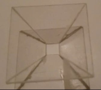

Step 9: Finished Image
In the testing i used my own hologram video. If you don't have your own hologram video you can visit this Link : https://goo.gl/KG4xTB
