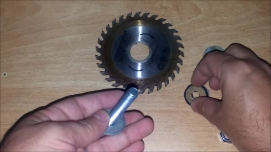

Step 2: Adapting a Small Standard Cutting Disc
Construct the cutting disc holder with :M10X 50 bolt and 3 washers and two rubber washers.
