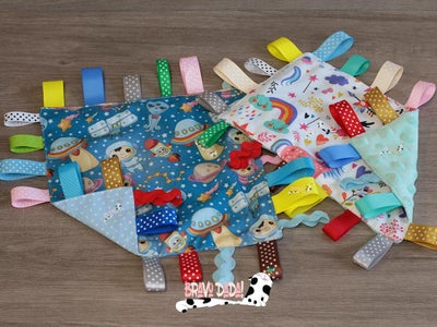

In this sewing tutorial I’m going to show you how to make two colorful baby sensory tag blankets of different sizes and shapes. These taggy blankets make a great gift for a lovely baby.

Step 1: Mark the Stitching Lines
- Start by cutting the fabrics and the ribbons for your tag blankets.
- (Optional) Heat seal the ends of the ribbons using a pocket lighter.
- Then, mark the stitching lines with a heat erasable pen. This step is essential to ensure that the ribbons won't be placed too close to the edges of the fabric or to each other at the corners.
- The seam allowance is 1.5cm | 0.6" for both the rectangular and the square tag blankets.
Step 2: Place and Clip the Ribbons to the Fabric Pieces
- The length, quantity and distance between the ribbons will depend on your preferences.
- Place the ribbons on top of the front fabric pieces of each blanket, as shown in the images, and clip them to the fabrics.
- For the rectangle tag blanket, I used 25 pieces of ribbon and left approximately 2.5cm | 1" distance between them.
- For the square tag blanket, I used 20 pieces of ribbon and left approximately 2cm | 0.8" distance between them.
Step 3: Stitch the Ribbons Onto the Fabric Pieces
- Adjust the stitch length according to your preferences. Use a 90/14 size needle.
- Using a 0.7cm | 0.3" seam allowance, sew the ribbons securely onto the front fabric pieces of each blanket.
Step 4: Sew the Front and the Back Pieces Together
- Place the right sides of the front and back fabrics facing each other, as shown in the images. Do this for both blankets.
- Draw the stitching line taking into account a seam allowance of 1.5cm | 0.6" or place a seam guide onto your needle plate. If your sewing machine has seam allowance guides or markings already, feel free to skip this step.
- Leave an opening of 8cm | 3.1" on each blanket, so you can turn the blankets right side out. Mark the opening on one of the sides of the blankets, as shown in the images.
- Sew both fabrics together following the stitching line or taking into account the seam allowance.
- Make sure that all the ribbons are out of the way and don't get caught into the stitching.
- Using scissors, trim away the extra fabric from each corner of the blankets.
Step 5: Turn the Tag Blankets Right Side Out
- Turn the tag blankets right side out through the space you left unstitched.
Step 6: Close Up the Opening of Each Tag Blanket
- Close up the openings of each blanket with an invisible hand stitching (optional).
Step 7: Press the Finished Tag Blankets
- Press the tag blankets. Do not press the ribbons or the minky.
Step 8: Edge Stitch the Tag Blankets
- Edge stitch 0.1cm | 0.04" away from the edge of the tag blankets.
