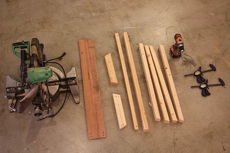

Step 1: Items Required for This Projecct
- (6) 1×3 lumber at 3 feet in length (you can go bigger or smaller, longer or shorter)
- (1) 3/4 inch x 5-1/2 inch plank or board at 3 feet in length. This board could be any length, but keep in mind that it will be your work surface and should be long enough to give you a comfortable amount of space to work on.
(2) 1×3 lumber at 1 foot in length
(1) Drill
(1) 1/8 inch Drill Bit
(1)Phillips Head Bit
(1) Miter Saw
(2) Wood Clamp
(24) 2-1/2 inch Wood Screws
(1) Pencil
(1) Measuring tape

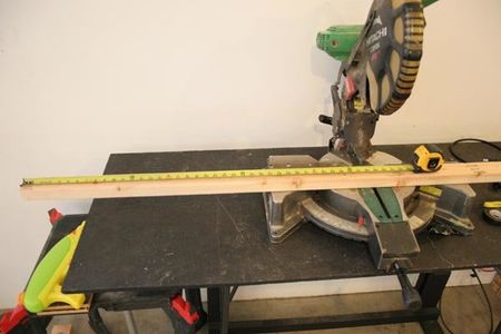

Cut four pieces of wood so that they are three feet long. We used 1×3 wood, but you could just as
easily use a different sized wood throughout. If you DO use different sized wood, however, be sure and also use that same size wherever we mention 1×3 pieces in this tutorial.
You can use a regular ‘ol handsaw for this as well.

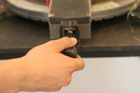

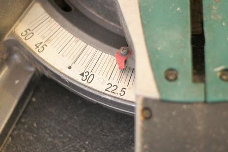

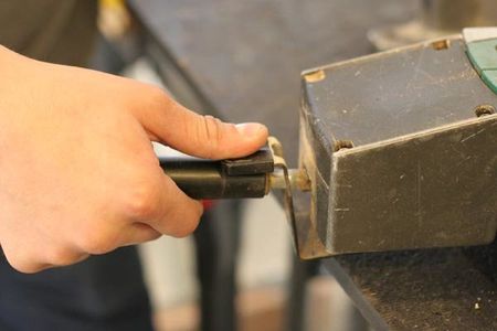

Step 3: Prepare Your Saw for Angled Cuts
All miter saws are different, but all follow pretty similar principles. To make angled cuts with a
miter, loosen the rubber handle at the front by twisting it counterclockwise.
With your thumb, press down on the lever that is above the handle.
This may not look exactly the same as yours, but it will likely be quite similar.
Rotate the cutting board to 22.5 degrees. We are cutting our boards at 22.5 degrees so they will lay flush against the sides of our sawhorse when it is ready and angle out away from the horse to provide a steady base. Don’t worry if this doesn't make sense yet.

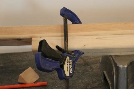

Step 4: Clamp Your Legs for Easy Cutting

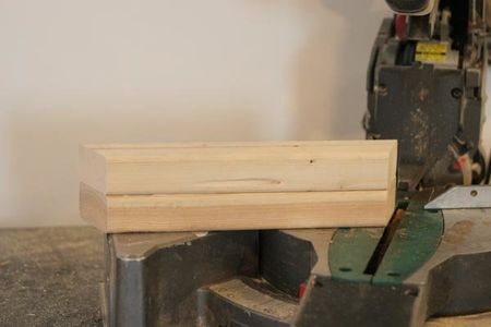

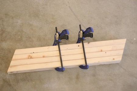

After you have cut your four leg pieces, clamp them together with some wood clamps. We are
doing this so we can cut all of our legs at once.

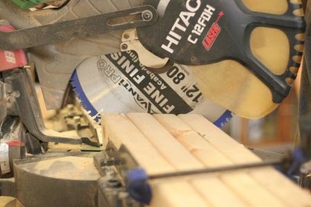

Step 5: Make Your First Angled Cut
Make the first 22.5 degree cut to either side of your clamped, 4board system. It does not mater
which side so long as the boards are laying on slimside as shown. Cut as close to the edge as you can while still getting a full angled cut.
Be sure to practice safety when using power tools.
Step 6: Make Your Second Cut
Cut the other end of the legs as well. Angle the cuts on the other side so that the sides run parallel
to each other. Same as the first angled cuts, cut as close to the ends as possible. The end result is shown in image.

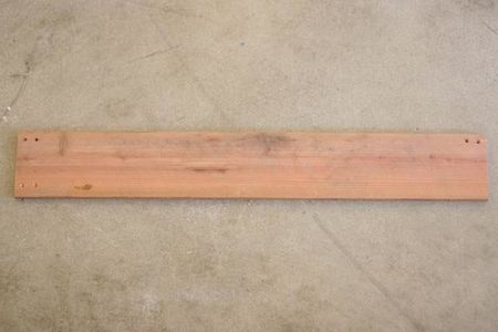

Step 7: Get Your Top Piece
Grab a board for the top of the sawhorse. We made our top board 3 feet long, which means that
our sawhorse will be three feet long. In other words, this will give us three feet of space to saw things on. Your board could be longer or shorter – just pick a length that will give you ample room to work comfortably.
We found this old board lying around the shop.

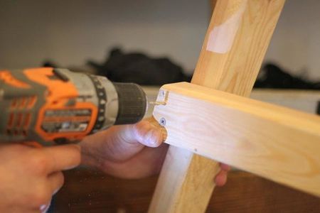

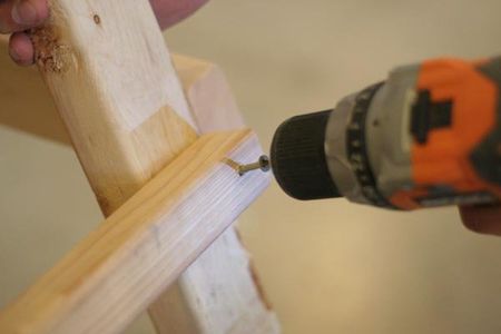

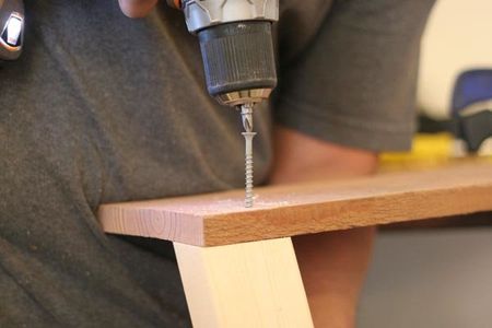

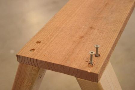

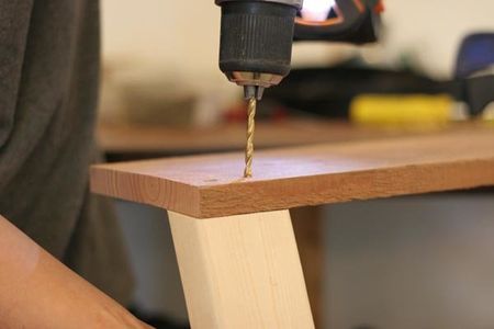

Attach the legs to the top board with screws. Begin every hole with a drill bit slightly smaller than
your screw so that the wood does not split when the screw is fastened. We’re using a 1/8 inch drill bit.
Fasten the leg to the board with a screw. We used 21/2 inch wood screws, but any length will work so long as the screw can pass through the board and at least one inch into the leg. Hold the leg flush against bottom of your top board when drilling. The top of the leg should fit perfect under the board while the bottom of the leg should angle out and fit perfectly on the flat floor.
Repeat this so that each leg has two screws attaching it to the board.

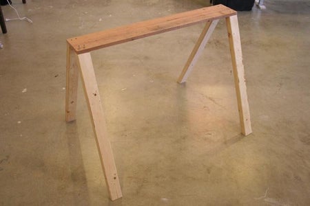

Step 9: Do This for Every Leg
Repeat this for every leg, creating two A shapes on either end of your top board as shown.
Your sawhorse is almost there, but it is a little wobbly. Better add some support braces!

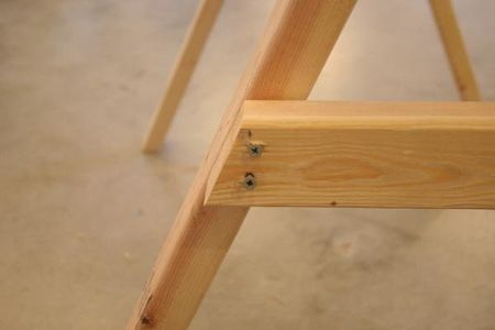

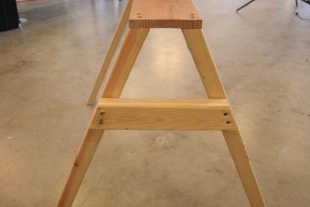

Step 11: Add the Braces

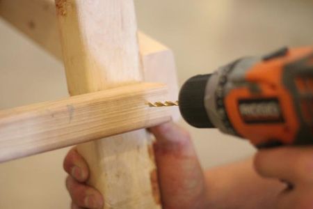

Align these braces with the table legs so that they are flush with the outside of the legs. If they are
the same size, they will sit flush at the same height from the floor on both sides. Fasten the braces to each leg with two screws.

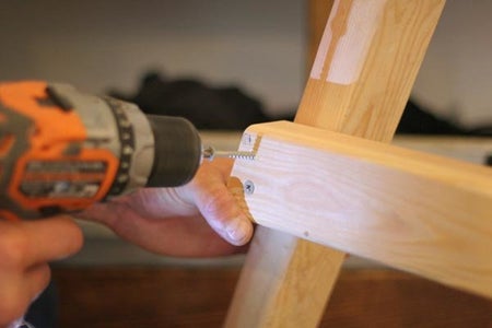

As always, begin by first drilling a pilot hole with a drill bit that is slightly smaller than your screw.
Pilot holes prevent the wood from splitting.
Fasten the brace to each leg with four screws, two on each side.
Repeat for the other side.

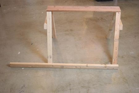

Step 12: Cut Long Support Braces for the Sides

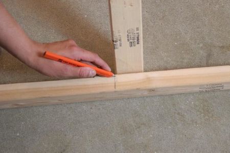

Cut two boards to be the length of the table (again, 3 feet long in this instance). You don’t even
need to break out the tape measure again if you don’t want, just place them next to the legs and mark the table’s length with a pencil.
The other board we used for this is a 1×3.
Stack the marked 1×3 on top of another cut them to match, so you have two equal braces. We actually ran out of 1x3 s in the shop, so we just used one 1×3 for one brace and a smaller 1×1 board for the other. Hey, you use what you got!
Step 13: Attach Long Braces
Attach the braces to each leg with two screws. Or, if working with thinner boards, just use one on
each side.
Complete this for both sides and you'll have a sawhorse that's great for, uh, sawing stuff.
