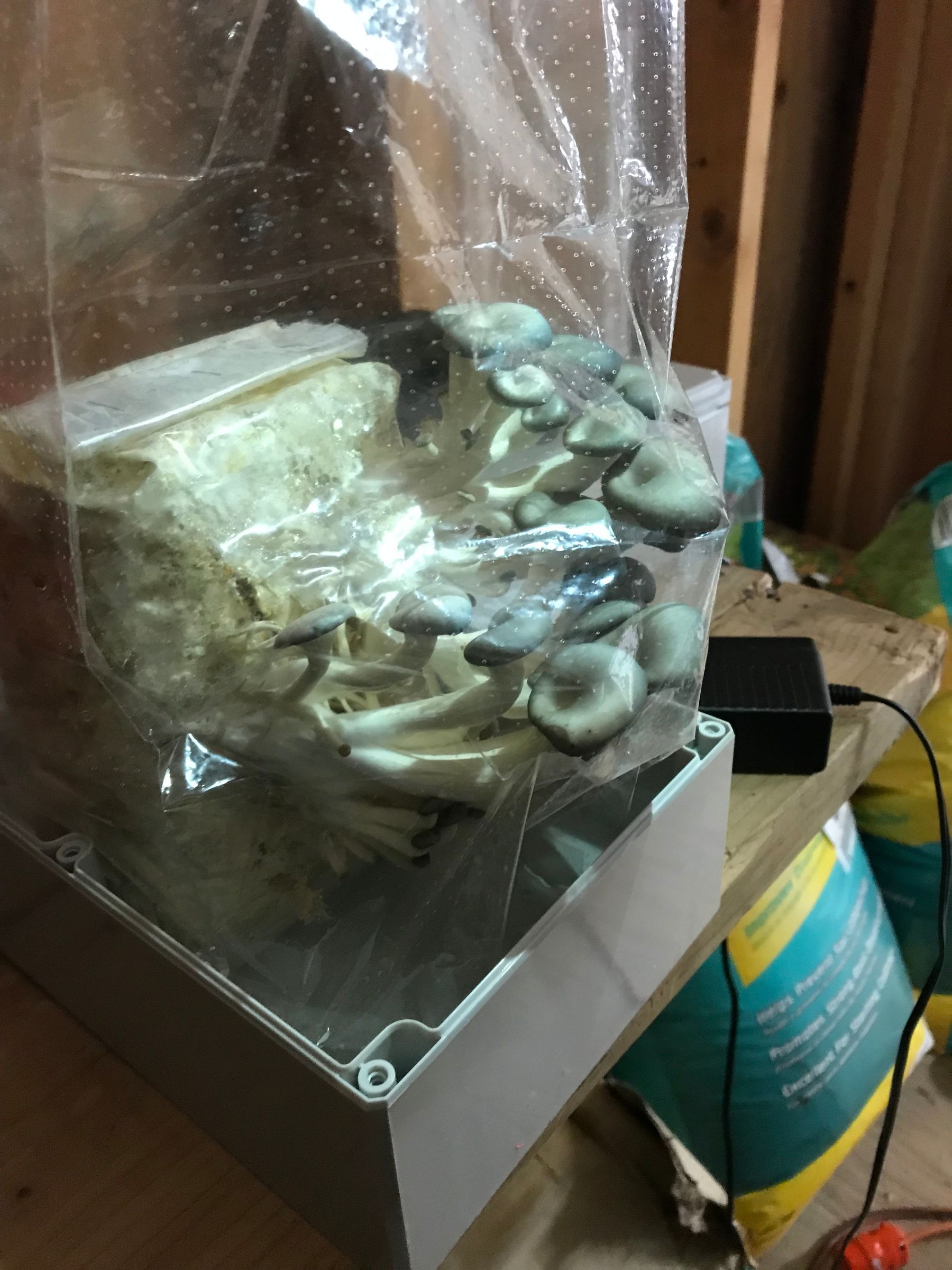

Do you need more humidity in a room? I built this humidifier to help keep my mushrooms happy, but this design would work for any of your humidity needs!

This is a very simplistic humidifier, and this instructable is ripe for modification.
The main issues with my humidifier were:
  • It very inefficiently gobbled energy for an un-regulable amount of time. In future versions, I highly recommend adding a timed switch-off feature and some regulator of electricity consumption.
  • Sponges make extremely mediocre evaporating surfaces. On one hand, they do facilitate evaporation. On the other hand, they are a breeding ground for bacteria and never dry out.
