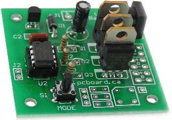

The IR Illuminator is based around our LED SpotLight PCB which holds a total of 24 LEDs on a circular PCB. The board is equipped with 24 special IR LEDs which do all of the work, along with 8 current limiting resistors. This project is very simple to build up, and can be fully assembled by a novice builder in about 30 minutes.

Once you have all the parts, the first step is to become familiar with the PCB. It is setup with 24 LEDs in total, 16 around the outside and another 8 on the inside (all the LEDs are labeled D1 to D24). The resistors will go on the board at position R1 to R8 which are located between the inner and outer rows of LEDs. Finally, power is applied to the board just below D24 where you will see the Positive and Negative solder pads. In the very center of the PCB is a single hole. This hole can be enlarged to be used for mounting or even further to fit around a camera lens.

The simplest way to begin the install is to insert and solder into the board the inner row of LEDs. These are located at D3, D6, D8, D12, D14, D17, D19 and D22. Keep in mind that LEDs are polarity sensitive, so ensure that you line up the flat on the LED with the flat on the solder mask on the board. After you have soldered in the first 8 LEDs, trim the leads.

Now you should install and solder in the LEDs at D1, D2, D4, D5, D7, D9, D10, D11, D13, D15, D16, D18, D20, D21, D23 and D23. When installing the LEDs, try to keep them flat against the board.

The last step is for the installation of the 8 current limiting resistors which go at positions R1 to R8. The resistors will stand on their ends for this project. Unlike the LEDs, the resistors are not polarity sensitive and can be installed any way you want.
