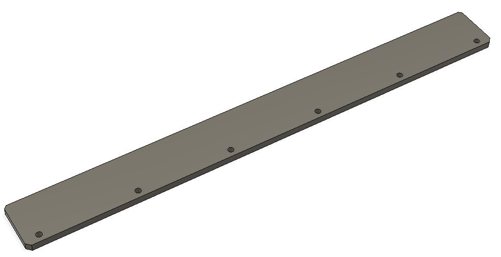

| 1x | steel_plate_top | ![]() |
| 1x | steel_plate_bottom | ![]() |

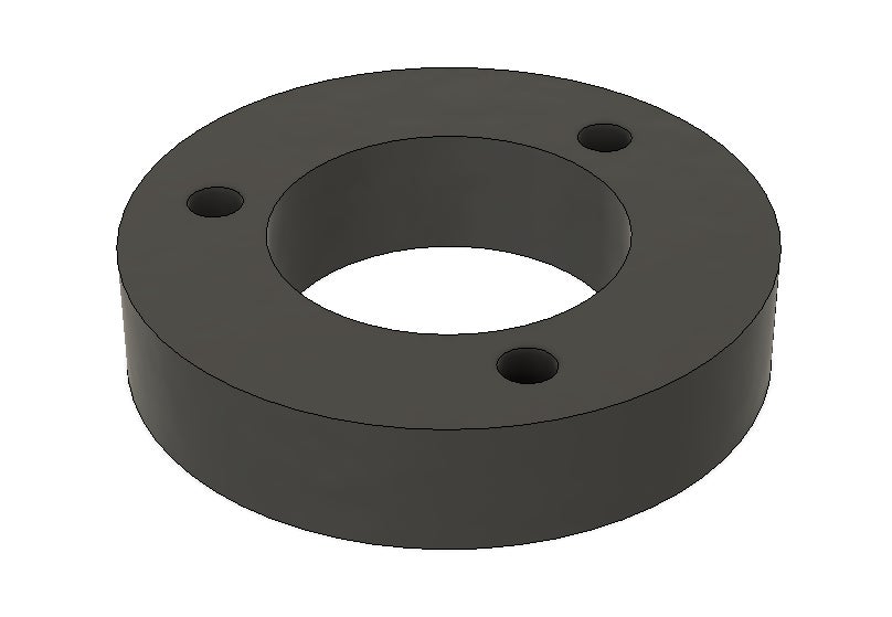

| 1x | encoder_spacer.stl | ![]() |

| 1x | steel_plate_top (in my case painted black) |
| 1x | steel_plate_bottom (in my case painted black) |
| 1x | 20x40x400mm aluminium extrusion |
What you have to do:
At frist you have to take the upper steel plate and place 24 magnets with alternating polarity on it. For the right distance of 3,33mm between the magnets I've created an allignment tool (See picture [2] below). Once all the magnets are in the right position, you have to fix them at their place with some super glue. Now repeat this procedure with the bottom steel plate.
Now you have to combine the upper and the lower steel-plate by using the six M4 Screws. You do that by using the "spacer" aluminium part. Because the magnets are so strong, I recommend to use a piece of wood or something similar to protect the magnets while assembling the steelplates.

| 1x | "encoder_spacer.stl" 3D-printed part |

At first you have to slide the GT2 Pulley on the encoder. Then you need to fix the Pulley by using the allen screws inside the pulley.
Now take the encoder and connect it to the "encoder_plate". Do that by using the three M3x16mm screws and the encoder_spacer.
