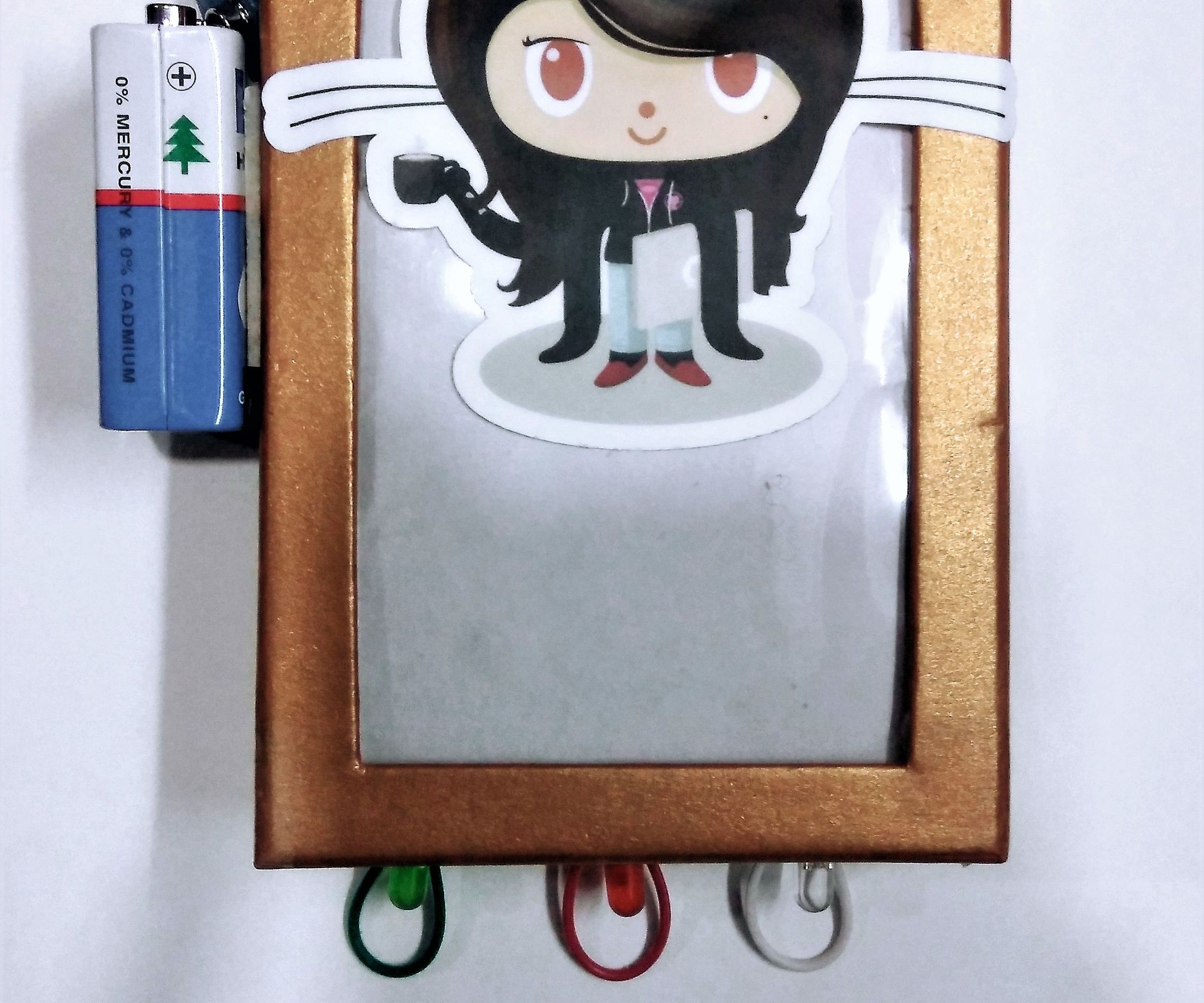

Step 3: Step 3 : Procedure
Start by pasting led strip on the outer side of the rectangular aluminium support. Make sure you leave one shorter side. Cut the strip from the marked position and solder two copper wires of the length, half the length of shorter side of your rectangular support on (+12 v) and (- negavtive) terminals of the LED strip.
Take another piece of LED strip and solder the other terminals of copper wires to +12v and – terminals respectively. Make sure the polarity is correct.
Now paste the LED strip on the inner side of support covering all the four sides. Take the help of given pictures for reference.
Next you have to take two insulated wires and solder them to the end terminals of LED strip. Connect the other terminals to female adapter.
Finally take the wooden block. Make two slots one, for mirror and another for two way mirror. Now you’ve to stand the prepared akuminium support covered with led in the middle of wooden block. Either use glue gun to paste it or screw it on the block. Now place both the mirrors in the respective slots making sure two way mirror face the reflective side of the mirror.
Plug in the 12v adapter and connect it to the jack. Switch it ON! Your DIY illusion mirror lamp is ready!
