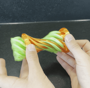

Recently the "Impossible Passthrough Illusions" have gained quite a lot of popularity. However I noticed the designs were all very similar. There were mainly pyramids, cones, hyperboloids and chess pieces. So I decided to create some different designs and make it as easy as possible for you to create your own design as well.

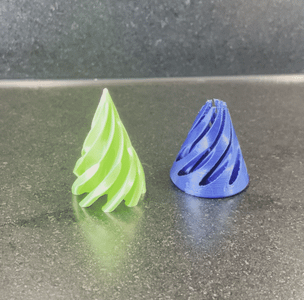

Step 6: Pyramid
I started off simple, by creating a cone shaped version
  1. To do this I created a sketch on one of the side planes (xz or yz)
  2. Next I drew an isosceles triangle and added a line down the z axis
  3. To finish off the cone I revolved one of the pyramid halves around the z axis and set the combine function to "Intersect". This reveals the finished cone shaped 'Impossible Passthrough Illusion'.

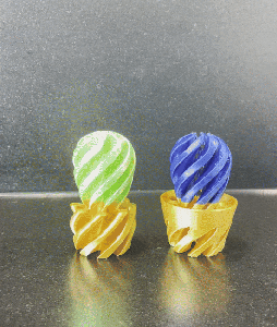

Step 8: Cactus
The cactus was made in a similar way to the hyperboloid:
  1. I drew a sketch in the shape of a cactus with the pot using splines (cactus) and lines (pot)
  2. Next I revolved the cactus sketch around the z axis and intersected it with both parts of the base created in Step 3
  3. After that, I filleted some sharp edges
  4. While printing, some parts tended to get ripped off from the build plate and so I created a 1 layer tall bed adhesion helper using 2 circles and little tabs patterned around the origin
Download the cactus shaped version here: https://www.printables.com/model/1022866-impossible-passthrough-starter-pack

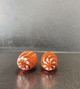

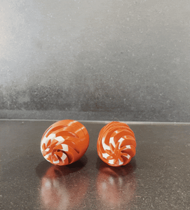

Step 9: American Football
The American football wasn't much different either. However modeling the entire football and printing it would require support material and would ruin the surface finish. That's why I decided to model only one half, print it twice and glue both halves together.
  1. I started by uploading a picture of a football into Fusion 360 using the canvas tool
  2. Then I traced the shape using splines
  3. After that I revolved one half (actually a quarter of the entire football) around the z axis and combined the resulting body with the two bodies created in Step 3
Download the football shaped version here: https://www.printables.com/model/1022866-impossible-passthrough-starter-pack
Step 10: Alignment Tool for the Football
In the previous step I decided to print the football in two halves. However aligning these halves perfectly is really difficult. I tried to add alignment pins, but they were too small and fiddly to insert. Instead I decided to create an alignment tool and little holes to insert hot glue.
  1. To add small holes into the bottom of the part I drew two 3mm circles on the bottom face of the football
  2. Next I extrude-cut these little circles into the part 1.5 mm and chamfered the edges
  3. After that I patterned these two features 8 times around the origin to get 16 holes for hot glue
  4. To created the alignment tool, I cut off the upper part of the ImpossiblePassthroughBase using a rectangle with a height of 10mm which I symmetrically extrude-intersected with the ImpossiblePassthroughBase
  5. Finally I chamfered all the resulting edges.

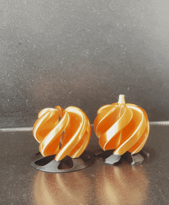

Step 11: Pumpkin Part 1
The pumpkin got a little more complex. I wanted the ridges in a regular pumpkin to follow the ridges that result from creating an Impossible Passthrough Illusion. However most pumpkins have 10-12 ridges and not 16 (as in my current sweep form). That's why I had to create a new swept profile.
  1. To do this I created a line from the origin and patterned it 10 times around the origin
  2. Next I regularly connected every other connection between the open ends and encompassed the whole design in a circle
  3. After that I filleted all the resulting edges
  4. Then I drew a smaller circle and set the inner lines as construction geometry
  5. Finally I offset the middle sketch loop 0.7 mm (generous tolerance)
Download the pumpkin shaped version here: https://www.printables.com/model/1022866-impossible-passthrough-starter-pack
Step 12: Pumpkin Part 2
  1. After finishing the sketch I swept the inner and outer profile along the line I created in step 3
  2. Then I drew a pumpkin on a pedestal on the xz plane which I then revolved and intersected with the swept bodies
  3. To imitate the actual ridges in a pumpkin I wanted to round off the sharp corners and tried to use the fillet tool. However this gave me some problems, which I eventually solved by not using "chain selection" and using variable size fillets

To print these designs, you can use your regular slicer settings. All the models are pre-oriented and can be printed without supports. Print them in any color of pla/petg, but it you're willing, a few color swaps at the correct heights can really enhance the appearance. My printer has terrible clearance (I haven't calibrated it yet) and I wanted my parts to slide effortlessly together, so I chose a clearance value of 0.7mm (quite large). If you notice that the parts are too loose you can adjust this in the slicer by changing the horizontal expansion value to something like +0.2 for a 0.5mm clearance (0.7-0.2). But even if the parts are very loose, the impossible passthrough illusion should work just as well.
Step 14: Football Assembly
The football is the only model that requires some assembly
  1. To assemble the football, slide the alignment tool onto one of the halves of the football
  2. Then apply hot glue (or something like E6000 or Uhu Glue) to the other half
  3. Slide on the other half and temporarily hold it in place with some masking tape
  4. Repeat with the other part
