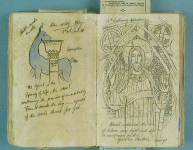

Some of the original pages have blue coloring applied. You can see pictures of the original pages on Zen Seeker. This can be reproduced using some blue watercolor paint.

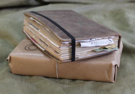

Finally, we can add a black elastic band and recreate the wrapping using some brown wrapping paper, prints of the Venice stamps and label, as well as some flax cord. If you have a 3D printer, you can use this model to recreate the ink stamp: https://www.printables.com/en/model/393553-venice-italia-stamp-for-grail-diary
And there you have it... a real life grail diary :)
