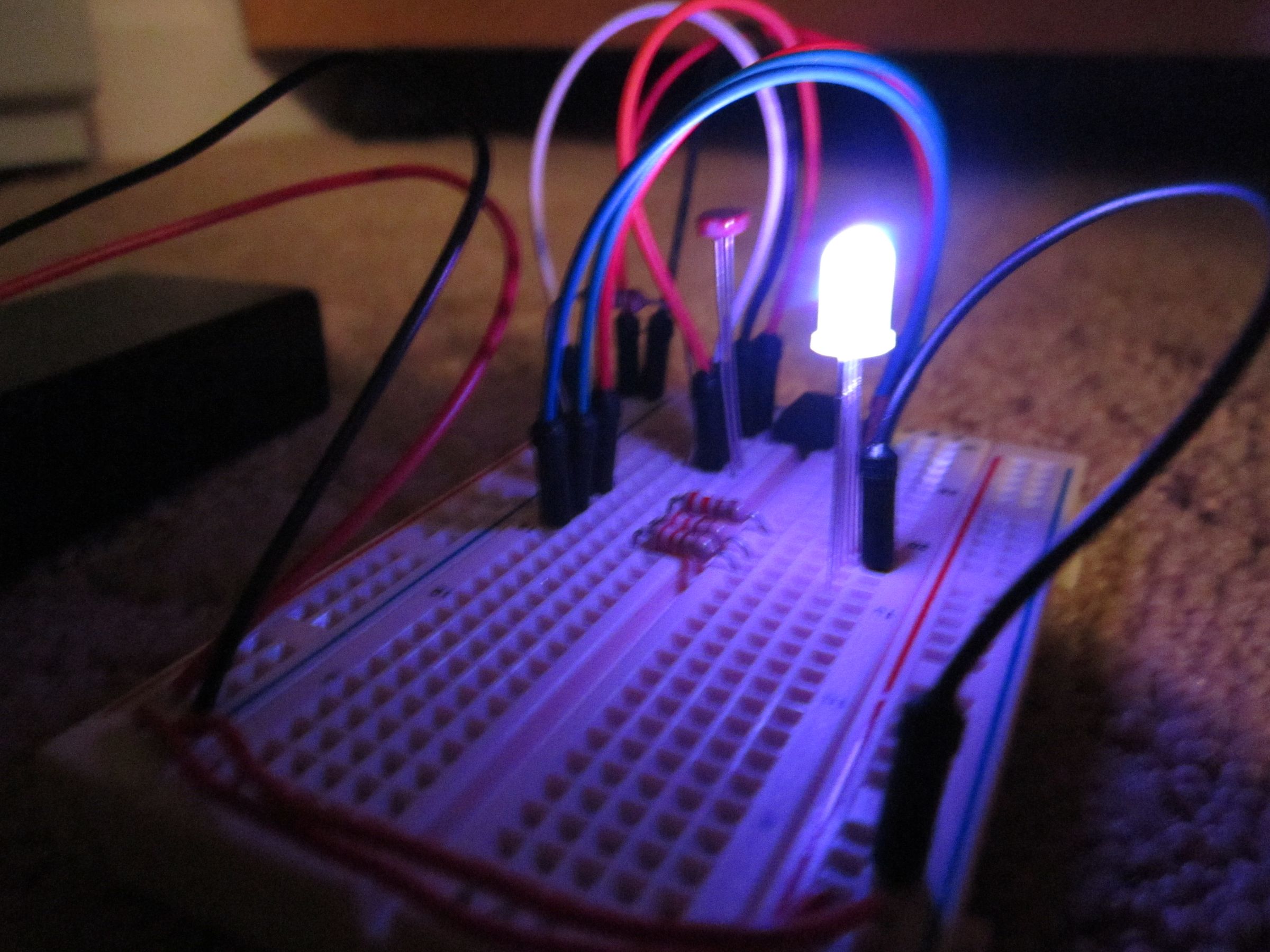

Step 5: Wire It Up!
Follow this schematic diagram to connect the LED and receiver to the Arduino.
Note: Your IR receiver may have a different pinout than this, so consult the datasheet for your receiver and check the pinouts. If you are not sure, then connect it the way shown in the schematic and see if it works. Most receivers have this pinout.
Note #2: You must have the LED and the receiver next to each other, but not facing towards each other. You must have them pointing in the same direction as shown in the second and third pictures.
