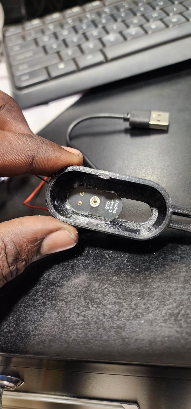

I tried to build my own version of USB Power mount. BUY one of these .
Step 2:

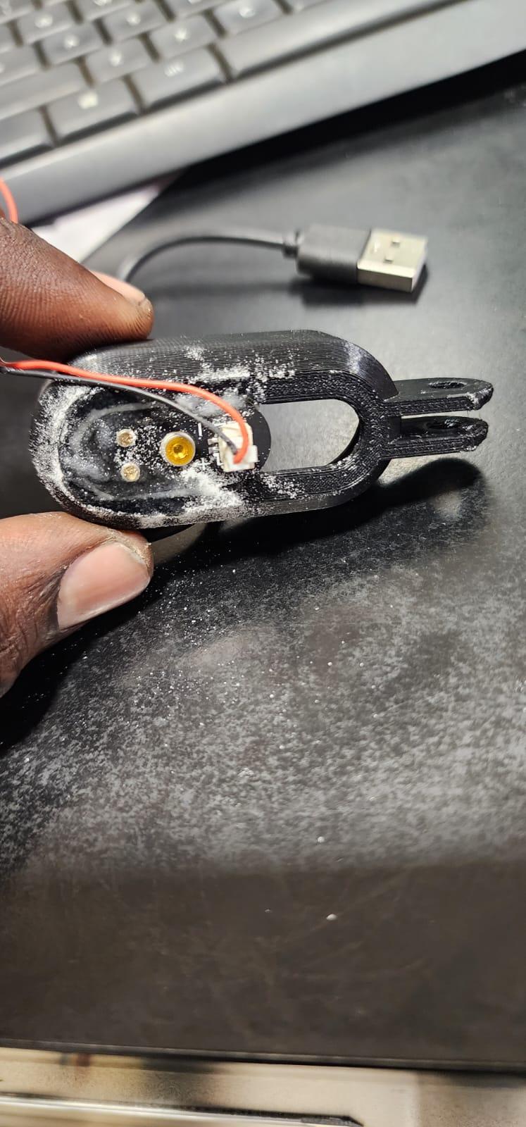

3D print one of these mount and alien the contact pin to exact location
Step 3:

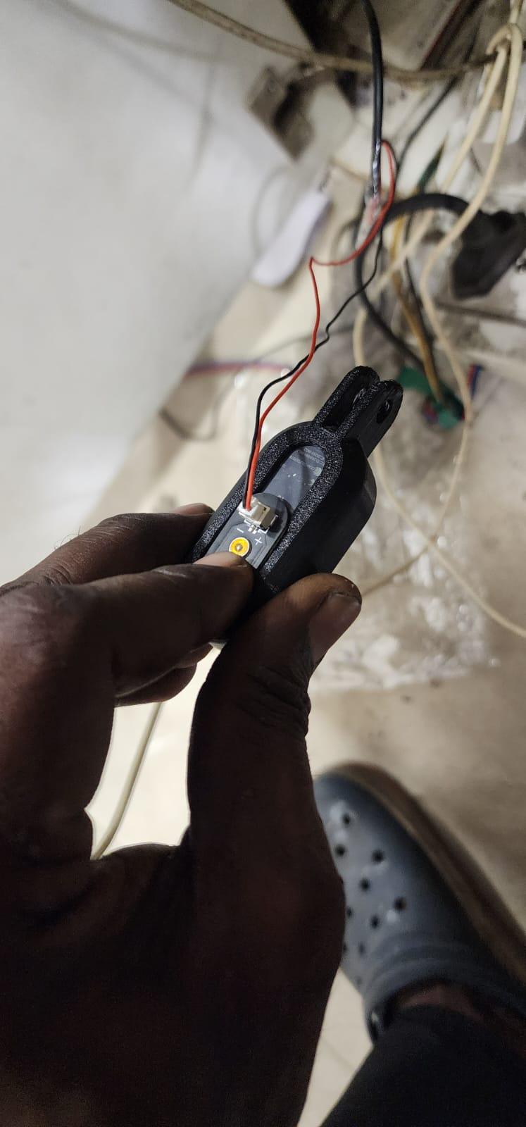

Use a hot glue or use a superglue to fix it to the mount.
Step 4:
join the positive negative to a USB type A.

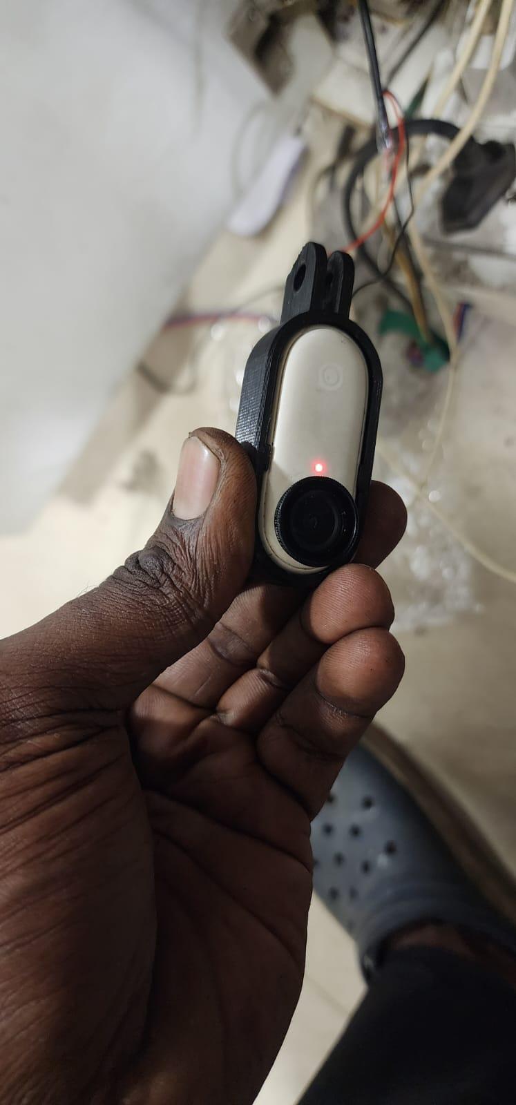

Step 5:
plug the USB a to a power source 5V, Powerbank also works
