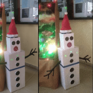

Hello there I'm happy that this project caught your interest. So last Christmas I turned a normal snowman into an interactive snowman using an Arduino and an Ultrasonic sensor. Here I used a snowman because it was already made of cardboard and the inside was hollow. u can use any character, for any occasion with the same mechanism.
How does this work?
It's pretty simple. If someone passes in front of the snowman, the sensor will sense it, and the arm of the snowman will move.

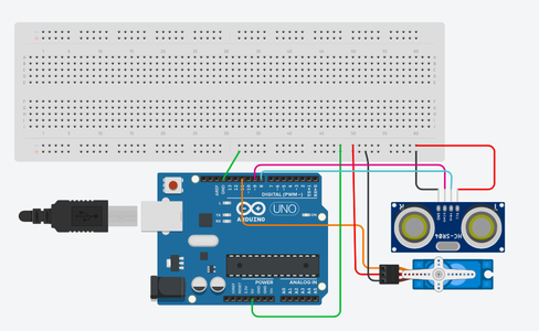

This is the circuit I made with Tinkercad Circuits.
Here you can see that the trigger pin and Echo pin of the sensor are connected to D8 and D9.
The signal pin of the servo is connected to D11.
Others are voltage and ground connections.
Make sure that the Arduino Uno will get a sufficient voltage supply otherwise the servo won't work properly.

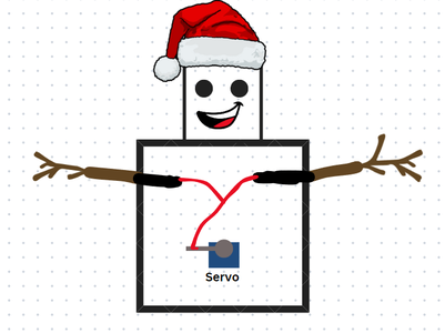

Step 3: Arm Mechanism
This is the basic idea.
Extend the length of the arm to inside the cardboard. attach threads at the end of the arms.
Fix the servo below the middle position and increase the shaft length for a better angle. Then attach the other end of the thread to the shaft. try to get the proper position and angles before fixing it.
