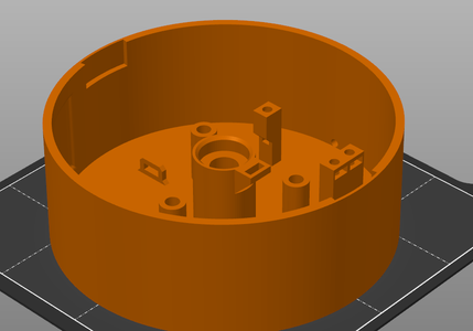

- The base is the bottom piece, where all of the electronics are

Step 6: Prepping the Base
There are a lot of moving pieces in the base (okay, well one moving piece, but a lot of important functional pieces). Buckle up.
- Prepare the bearings by putting the small 3D-printed bearing adapter pieces into the center of two of the bearings (sorry, I don't have a picture for this)
- Place the bearings into the center hole on the base, in the top and the bottom. These bearings will support the center rod.
- Screw the longitude servo into the base using 3 nuts and 3 bolts. The bolts will go into the small shelves on the podiums (see the picture)
- Fit the servo attachment into gear 22 that came with the servo. You can see which attachment to use by looking at the back of gear 22. Then, screw this gear onto the servo using the screw that came with the servo.
- Screw the PCB into the base using the 4 small wood screws.
- Solder wire onto a piece of brass tape, if using the touch lamp functionality
- Stick the brass tape on the inside of the base
- Plug the longitude servo and brass tape-wire into the PCB (the touch wire can be plugged into either terminal on the touch terminal)
- Place the brass rods in the 3 extending sleeves in the base
Also, now's a good time to strip the end of your power supply wires and fit them into the base through the hole on the back. Screw these wires into the power terminals on the PCB.
