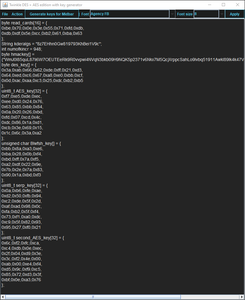

Step 7: Generate Keys
To make the unauthorized deciphering of your data computationally infeasible - It is crucial to generate your own keys and never reuse them
It's entirely up to you how to generate the keys. I can only offer you an option to do so.
I've modified one of my previous projects to work as a random number generator, the generated output seems "random enough" for me, but I haven't run any tests. So, I can't guarantee that it's random.
Use it at your own risk!
To generate the keys - launch gen.exe from the "V1.0\Untested RNG" folder and click the "Generate keys for Midbar" button. The background turns from dark gray to light gray when you press that button.

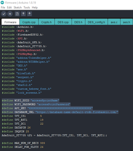

Step 8: Modify the Firmware
Open the "Firmware.ino" file from the "V1.0\Firmware" folder and put your values to the following variables:
WIFI_SSID
WIFI_PASSWORD
API_KEY
DATABASE_URL
After that, replace my keys with yours.

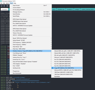

Step 9: Switch the Partition Scheme to the "Huge APP (3MB No OTA/1MB SPIFFS)"
You have to switch the partition scheme to the "Huge APP (3MB No OTA/1MB SPIFFS)" before you flash ESP32 because the firmware is too big for the default partition.

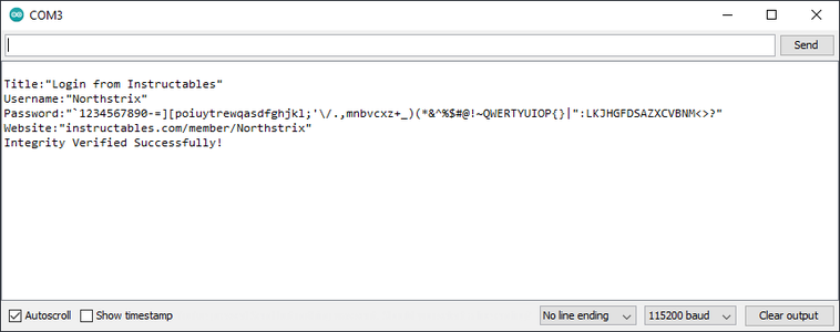

Step 15: View Login
To view login:
  1. Select the "Logins" line in the main menu;
  2. Press the "Enter" key on the PS/2 keyboard;
  3. Select the "View" line;
  4. Press the "Enter" key on the PS/2 keyboard;
  5. Choose the slot you want to view the login from by pressing the "←" (Leftwards Arrow) and "→" (Rightwards Arrow) keys on the PS/2 keyboard;
  6. Press the "Enter" key on the PS/2 keyboard;
  7. Press the "" (Upwards Arrow) key on the PS/2 keyboard to print the record to the serial terminal.
*All credentials demonstrated here are entirely fictitious. Any similarity to actual credentials is purely coincidental.
