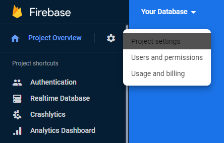

  • Open your database;
  • Click on the "Settings" icon;
  • Click on the "Project settings" line;
  • When the next tab loads, go to the "Service accounts" tab;
  • Click the "Generate new private key" button;
  • Click the "Generate key" button in the pop-up window;
  • Save the private key to the "V1.0\Desktop App" folder under the "firebase key.json" name.

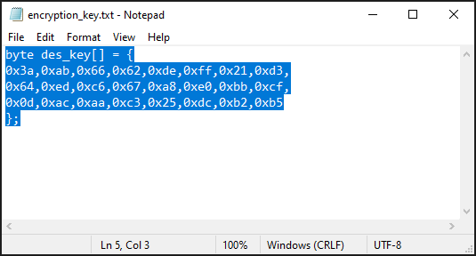

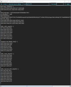

Step 7: Generate the Encryption Key
To use this device, you need to generate a 24-byte key. You can do this by any means possible. In my opinion, the easiest way to do it - is to take the key generator from Midbar, generate the keys, and only take the "des_key" from the output.
If you decide to go that path, note that although the output seems "random enough" for me, I haven't run any tests. So, I can't guarantee that it's random.
Use it at your own risk!
My encryption key:
byte des_key[] = {
0x3a,0xab,0x66,0x62,0xde,0xff,0x21,0xd3,
0x64,0xed,0xc6,0x67,0xa8,0xe0,0xbb,0xcf,
0x0d,0xac,0xaa,0xc3,0x25,0xdc,0xb2,0xb5

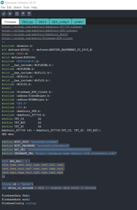

Step 8: Modify the ESL Firmware
Open the "Firmware.ino" file from the "V1.0\Firmware" folder and put your values to the following variables:
WIFI_SSID
WIFI_PASSWORD
API_KEY
DATABASE_URL
After that, replace my keys with yours.
Also, pay attention to the following lines:
String id = "Abcde"; - ESL ID. This is how the ESL knows what data belongs to it. It must be unique for each device.
int delay_in_seconds = 600; - Request data from the cloud each n seconds.

Step 10: Replace the Encryption Key in the Client Application
Go to the "V1.0\Desktop App" folder, open the "encryption_key.txt" file, and replace my encryption key with yours. Don't forget to save the file after you are done.

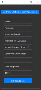

Step 13: Set the Data to the ESL
Open the "Launch.py" file in the Python IDE and run it. Once you do this, a form with nine entries and a button should appear.
Enter the ESL ID in the first entry, and fill out the remaining eight entries with the required data. Keep in mind that the ESL only displays 26 characters from entries 1 - 7 and 13 characters from the entry dedicated to price. Press the "Set Data to ESL" button after you've entered the required data.
It takes roughly a minute for the software to encrypt and upload the data you've entered to the cloud.
