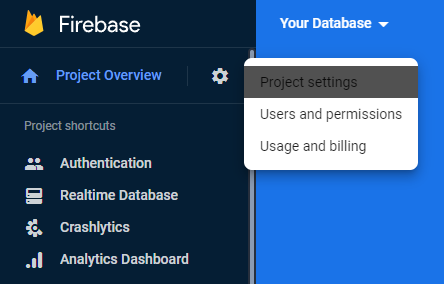

Step 7: Get Private Key for Firebase
To upload data to Firebase, you need to get the private key and place it in the same folder as the desktop (client) application.
To do so:
- Open your database;
- Click on the "Settings" icon;
- Click on the "Project settings" line;
- When the next tab loads, go to the "Service accounts" tab;
- Click the "Generate new private key" button;
- Click the "Generate key" button in the pop-up window;
- Save the private key to the "...\V2.0\Desktop App" folder under the "firebase key.json" name.
