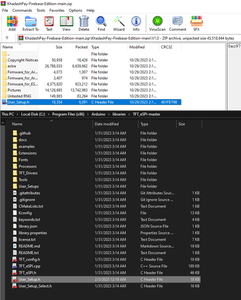

Step 8: Replace the Preset File for the TFT_eSPI Library
TFT_eSPI Library requires the config to be adjusted depending on the display and the board that drives that display. Initially, I wanted to write the mini-guide on adjusting the config for the ILI9341 display to be properly used on the ESP32's HSPI. But then I realized that it would be more convenient to attach the adjusted config to the firmware and tell you where to place it.
Take the "User_Setup.h" file from the "V1.0" folder and place it in the "C:\Program Files (x86)\Arduino\libraries\TFT_eSPI-master" folder.

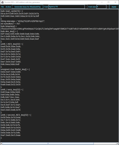

Step 9: Generate Keys
To make the unauthorized deciphering of the cloud-stored data computationally infeasible - It is crucial to generate your own unique keys and never reuse them.
You are free to choose the key generation method. I can only offer you an option for you.
I've modified one of my previous projects to work as a random number generator. Though the generated output seems "random enough" for me, I haven't run any tests. So, I can't guarantee that it's random.
Use it at your own risk!
To generate the keys - launch gen.exe from the "V1.0\Untested RNG" folder and click the "Generate keys for KhadashPay" button. The background turns from dark gray to light gray when you press that button.

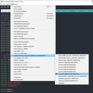

Step 11: Switch the Partition Scheme to the "Huge APP (3MB No OTA/1MB SPIFFS)"
You have to switch the partition scheme to the "Huge APP (3MB No OTA/1MB SPIFFS)" before you continue working with ESP32 because the firmware for the ESP32 is too big for the default partition.

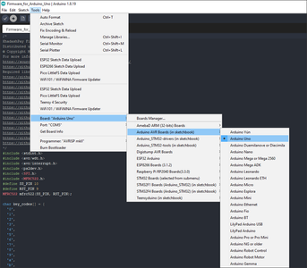

Step 13: Flash Arduino Uno
Upload the firmware from the "V1.0\Firmware_for_Arduino_Uno" folder into the Arduino Uno.

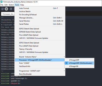

Step 14: Flash Arduino Nano
Upload the firmware from the "V1.0\Firmware_for_Arduino_Nano" folder into the Arduino Nano.
