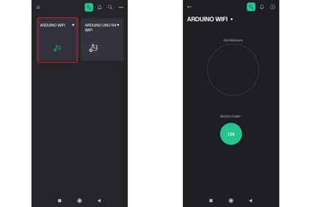

Step 5: Setting Up the Blynk for IoT Based Control
To control the watering system remotely, I used the Blynk app, which requires generating an Auth Token and Template ID. Here’s how you can set up the Blynk app:
  1. Create a Blynk Account by Signing up or log in at Blynk.io.
  2. After that enable developer mode In the developer section, create a new template for the plant watering system and configure it for remote control.
  3. Once the template is created, link a new device to it and get the Auth Token for the Arduino to connect with the Blynk cloud.
We already covered a tutorial for generating the Blynk Auth Token for this project, You can check there.
Step 6: Customize Blynk App Widget for Moisture Monitoring and Pump Control
Once the Blynk auth code is set up, you can move to the Blynk mobile app to configure the control interface. Here’s what to do:
  1. Install the Blynk IoT app from your app store and log in with your credentials.
  2. Create and customize a template for the watering system. Add necessary widgets, such as a button to control the pump and a radial gauge to display the soil moisture level.
  3. Set the virtual pins in Blynk for the gauge and button. The radial gauge displays the moisture levels, while the button controls the water pump.
You can also check out this Blynk Widget Customization guide, For step-by-step instructions on customizing the Blynk app interface as shown in the above image.

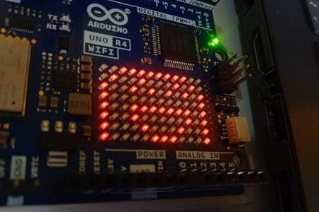

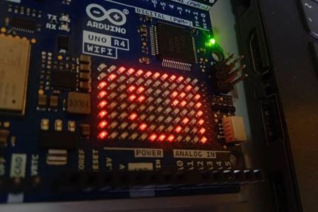

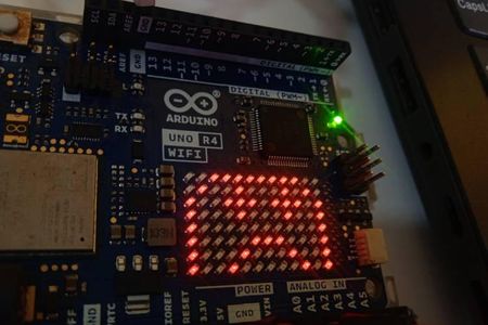

Step 8: Let's Watchout Plant Expression
After dumping the code, the Arduino UNO starts to display plant expression based on the soil moisture level.
  1. Laughing Expression appears when the soil is very wet.
  2. Smile Expression appears when the soil has a moderate moisture level.
  3. Sad Expression appears when the soil is dry.
