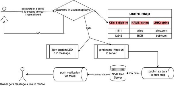

The (very) abstract design shows the entire flow starting from a guest inputting a password all the way through the final stage where the admin gets the notification, with various technologies and their part. please make sure to:
- Configure and install your Circuit Playground Express board (or other board) with the WiFi shield (mine is configured on pins A7 and A8) and Install some IDE via the links provided above, make sure the ports, necessary libraries, modules and files are properly configured, and that you are getting an internet connection

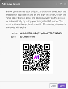

- Configure Apple IOS/Android modules, based on your phone, I present the IOS flow but the one for Android is the same:
- On the ‘Device’ section, press the ‘Add’ button,(example is attached as photo)
- Name your device and install the “integromat” App on your Apple device.
- Open the app and at the sign-in screen press “Use-code” and scan the QR given in the window (example image is attached)
- On the bottom menu click ‘Run once’, “Make” is now listening to incoming requests.
- On a new event trigger, a push notification (that contains a URL to a photo, or other link) will be sent to the device that was set up.

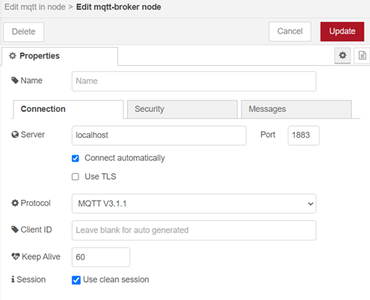

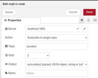

- Drag and add “mqtt in” node, double click it and fill as shown in attached image.
- Fill “Server” section in the "MQTT-IN" node as shown in attached image

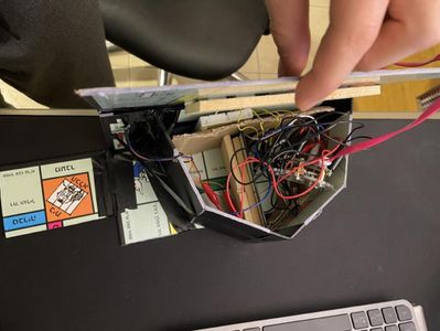

Step 7: Boxing
The boxing I used is an old torn up Monopoly board I found in the trash :D.
It is held together with some cardboard electrical tape, scrap wood, and double sided tape that was used to fix the LED matrix in place.
For me this is a temporary setup till my new soldering Iron arrives and I can wire everything up and put it in a cool 3D printed or a neat custom made wood box, will update on that so stay tuned!
