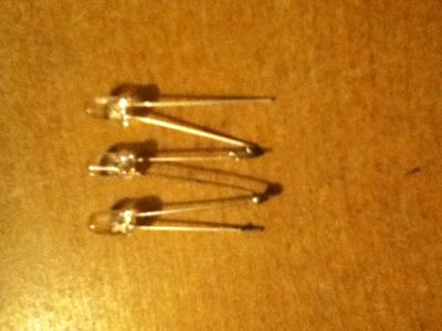

Step 3: Soldering the LED's
In one of these pictures they are not in the stand, but make sure to solder them when they ARE in the holes that you drilled in the stand. Solder the LED's like this. Solder the positive lead of one to the positive lead of the one next to it, the negative lead of one to the negative lead of the one beside it, and so on. you will probably have to clip the leads to make them shorter because you want all of it to take up as little space as possible. Tip: the longer lead is the positive one

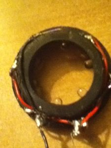

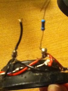

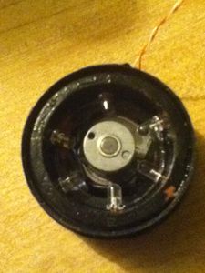

Step 4: Wiring
This is a confusing step so pay attention. Now you should have three groups of positive leads and three groups of negative leads. solder 1 wire to each group of positive leads, then solder those wires together( make sure that they run tightly along the fountain stand so that there is just enough room for the three of them to get soldered together, this is the first picture). Do the exact same with the negative leads soldering a wire to each of the three groups of leads and then soldering the three wires together. Now you have two sets of three wires. Solder one end of your resistor to the set of positive wires. If you did all of that right it should look something like this. (Second picture)

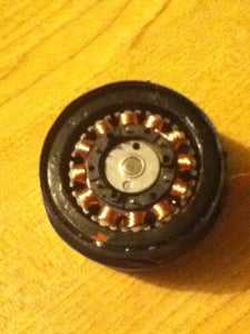

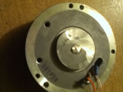

Step 5: Preping the Stepper Motor/ Assembly
The stepper motor has three parts: the top, the bottom, and the coil. you will need the top and the coil, and the wheel with the shaft on it thats in the bottom. Pull the wheel with the shaft on it off of the bottom and put it on the top. take the coil off and put it aside.Throw the bottom of the stepper motor away we wont be needing that. Now drill a hole in the body of stepper motor where the wires will come out, In my case there was already a hole there.
Now put the fountain stand inside the top section of the stepper motor, (it should fit snug if you did everything you were supossed to). Pull your sets of wires through the hole, and electrical tape your fountain stad to the stepper motor. Now put your coil back in so that it rests on the LED's, Glueing this in is optional.
Tip: If any of your solder connections are touching the metal stepper motor put hot glue or electrical tape over the connections so they dont touch metal against metal, to avoid a short circut should look like this

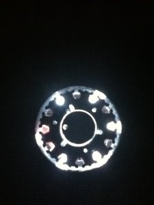

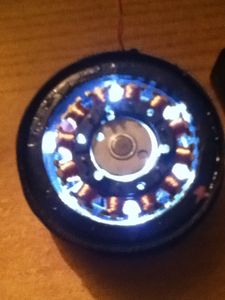

Step 7: Best and Final Step TRYING IT OUT!!!
So after you double check everything try it out, see if it works, and have fun!
