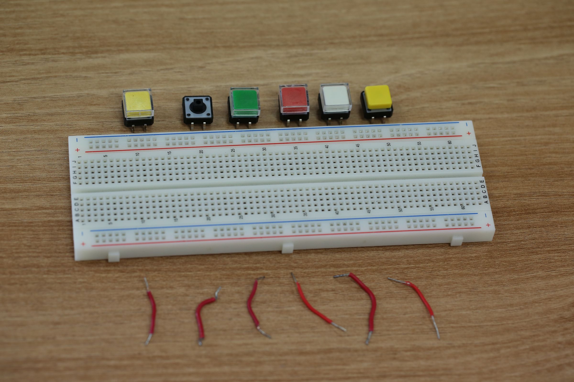

- Raspberry Pi 2 or 3 // ~$10~$35
- 16 GB SD card // ~$8
- Big breadboard // ~$4
- GPIO buttons + jumper and hook-up wires // <$2

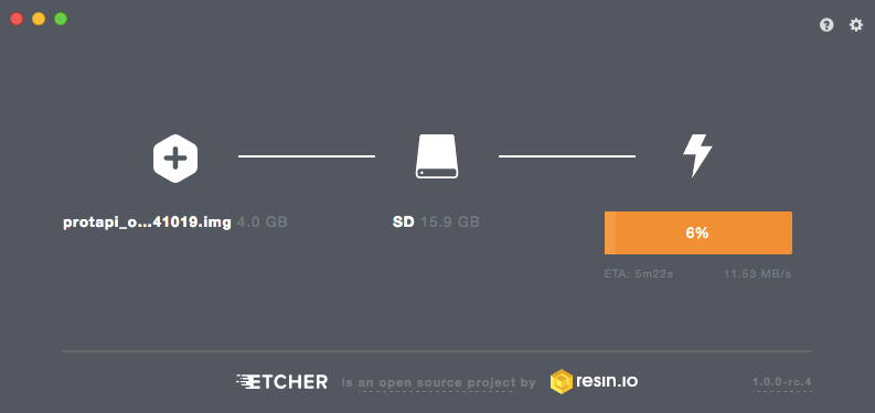

Prota OS can be downloaded for free on https://prota.info/prota/pi/. It’s only 3.8GB and easy to burn on a SD card (make sure to use a 16GB card).
Follow the instructions of Raspberry Pi foundation to write the OS image on your SD card. Extract the .img file from the zip folderPlug in your SD cardDownload and open Etcher, select the image and the drive and start the process. That’s it!
Once Prota OS is burned on the SD card, you can follow this simple installation guide to set up your Prota hub (less than 1 minute!). You only need to define its name and password, your time zone and your email address and the rest is completely automatic!

Step 3: PREPARE YOUR BREADBOARD
A breadboard is a board that helps you connect electronic components together and to your micro-computer Raspberry Pi. Using a big breadboard (830 points for instance) will allow you to have enough space to integrate many buttons. The more buttons you have, the more commands you can integrate with it, the more songs you can play at once.
First, let’s install the buttons on your breadboard. Separate each button enough. And connect hook-up wire between one of the leg of the button and the minus (-) line. That will allow us to use only one jumper wire for ground connection.
See GIF above
Now connect a jumper wire next to the other leg of each button (it must be on the same line number). This will make the data connection between your Raspberry Pi and the button to transform the physical push on the digital interface.
See 2nd GIF above

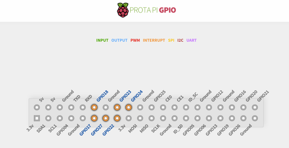

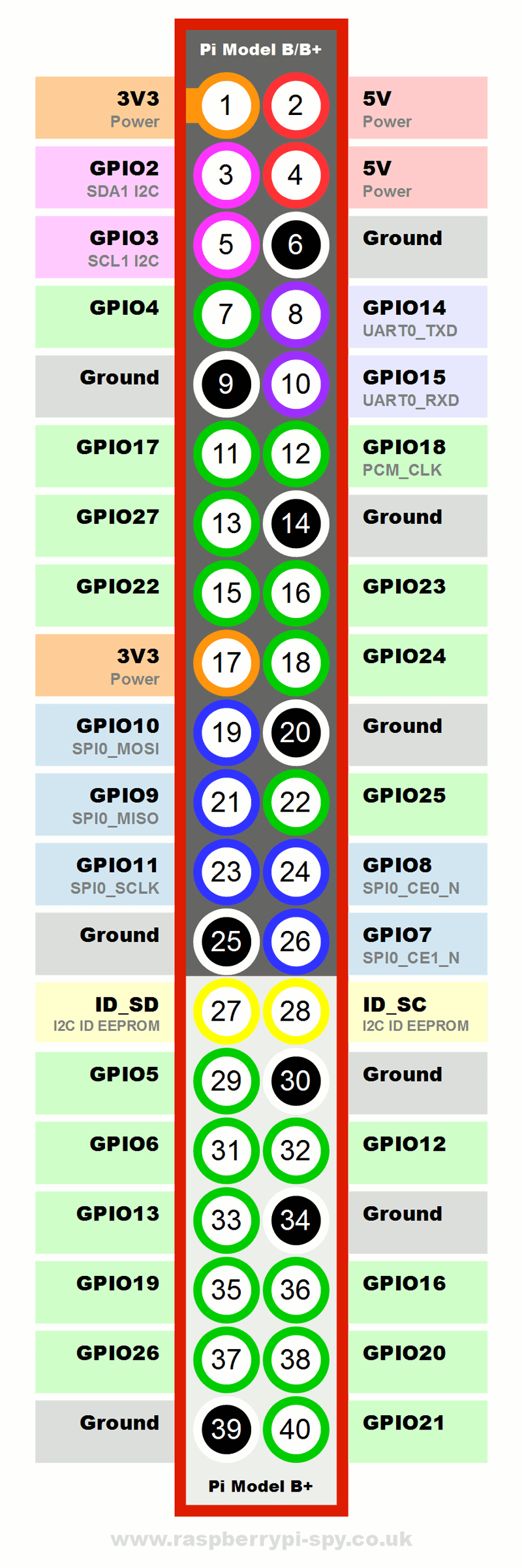

Now it’s time to connect those wires to the GPIO pins of your Raspberry Pi. Connect the wire in the ground line to a ground pin. Then connect each button jumper wire to GPIO pins, following the map below. For instance we chose here to connect with GPIO18, GPIO17, GPIO27, GPIO22, GPIO23, GPIO24.
Basically you can connect to any green pin on this map.

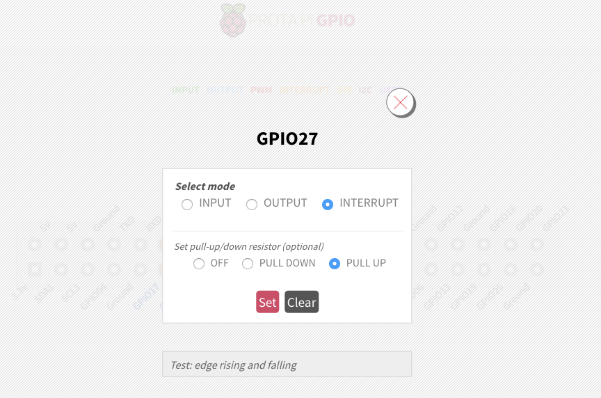

GPIO app is an app that allows you to create command names for physical elements connected to your Raspberry Pi, like those buttons. We will later connect these commands into automation workflows (step 7).
- Go to App Libraries and download GPIO app
- Open GPIO app
- Click on GPIO 18 and set it to Interrupt // Pull up
- Click on “Set”
Now when you press your button, it should display on your GPIO interface (as below) “Rising interrupt” and “Falling interrupt”.
This means your Prota Pi reads the action of pressing the button. Now you can do the same thing with the other GPIO pins. Make sure all dots are lighten up like below, meaning all pins are set up.
Test each button to see if you do have for each the message “rising interrupt” / “falling interrupt”, which confirms the connection is working fine.

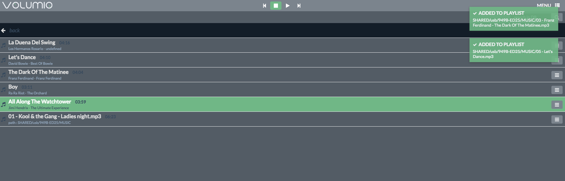

Volumio is the audio player of your Prota Pi. Set up your Volumio playlist to run your Jukebox.
First, put your favorite songs on your USB stick and make sure to name them in the same order than your buttons. For instance “1. Track 01” for first button, “2. Track 02” for the second button. Next, plug your USB stick to your Prota Pi.
Set up Volumio
- Go to App Libraries and download Volumio app
- Open Volumio
- Click on the bottom left button “Browse”
- There you will be able to select the songs and radio stations you want to play and/or add to a playlist
The shared folder contains the audio files added on your USB stick.
Make sure your playlist follows the order of your buttons.

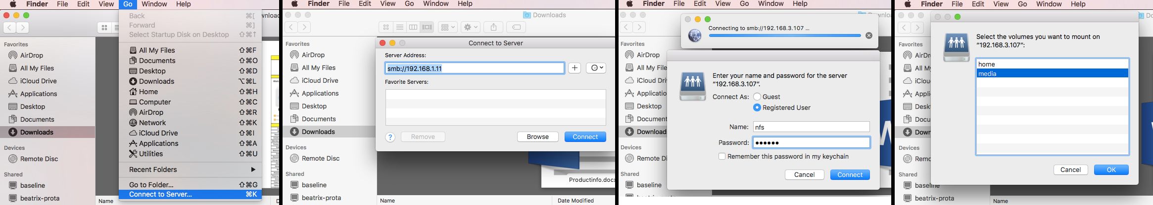

Once your app is configured, you will need to connect your computer to the NFS network from which you can access & modify the content of the USB stick.
On iOS devices:
- Open Finder and click on Go > Connect to server (in the top bar)
- Type in smb:// + the IP of your Prota
- Select “media”
- Your name will be “nfs” and previously setup password
- Click on “connect”. You can now access the files on your USB stick/hard drive from Finder.

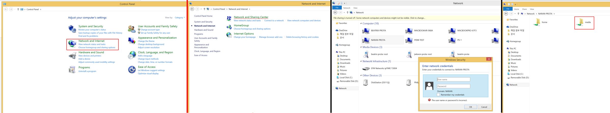

On Windows computers:
- Go to the Network menu of File Explorer
- The neighboring networks will start appearing. You should find in the list the name of your Prota Pi.
- Enter NFS as ID and the password you created on the NFS app
- Click on Media and you will be able to access the files on the USB stick
