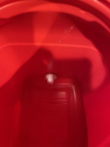

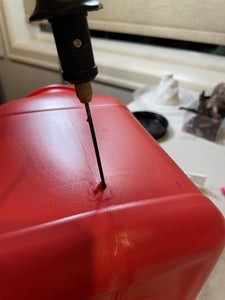

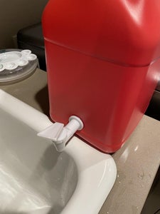

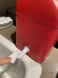

To make it easier to pour out the liquid fertilizer, we added a spigot at the bottom of the container. Start by drilling a hole on the side of the container. If you used a plastic container like we did, you can just use an electric hot knife/foam cutter. Smooth out the edges of the hole. Install the dispenser, following the product instructions (our dispenser came with two sealing pads to seal the gap between the spigot and the container). Test to make sure there is no leakage.

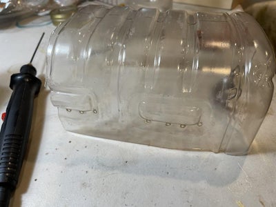

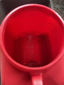

We would like to make a compartment for the liquid fertilizer to drain into so that the solid waste will not block the spigot. The compartment will also trap some oxygen next to the compost, increasing the composting speed.

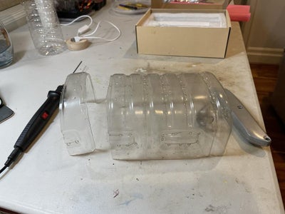

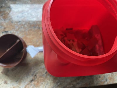

We used a sturdy juice bottle for the compartment frame. Cut it to a length that can fit inside the container. Then, cut off one side so that the plastic forms a U shape and adjust its height so it is higher than the spigot. Drill holes to provide drainage and ventilation.

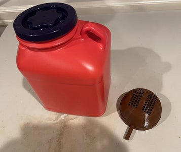

Step 3: Two-Section Spoon
The proportion of Green and Brown can vary depending on region and season, but most of the time the 1 to 1 ratio should work fine: https://www3.epa.gov/recyclecity/compost.htm

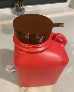

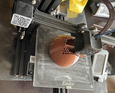

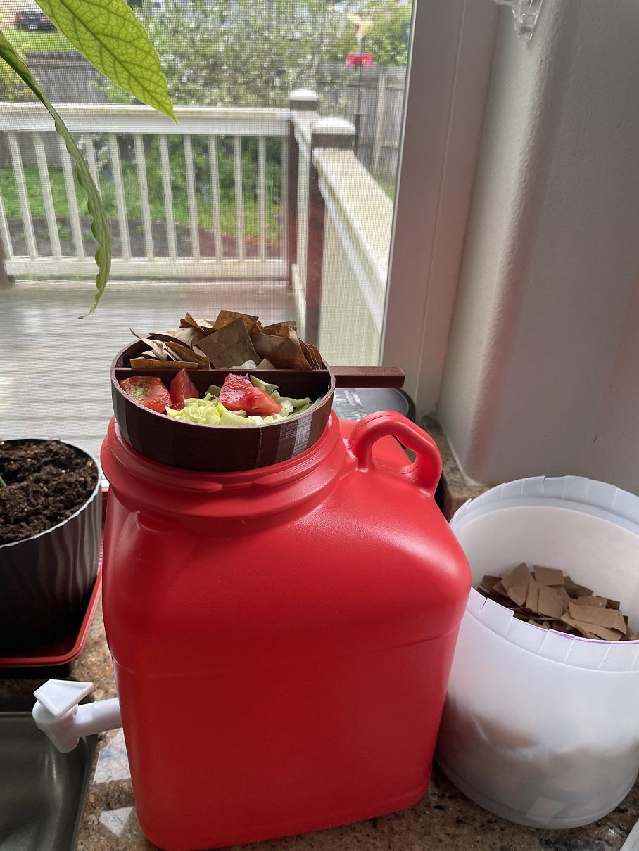

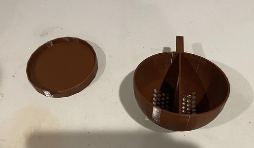

To help us do this easily, we designed a special measuring cup split into halves. The measuring cup sits on top of our container (the spoon is slightly bigger than the opening to ensure that it can't fall inside the container). You will need to adjust the size of the spoon if your container has an opening of a different size. I also designed a lid, for the cup, as the cup replaced the lid of the original container.
3D print the spoon and matching lid.
Instructions for using this split measuring cup are provided in the following steps.
Step 4: Container Lid

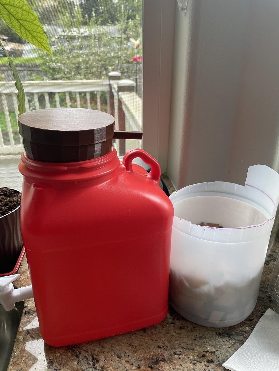

If the kitchen compost container is not full, the cup and lid can be used to serve as a cover for the whole container. Once full, we need to cover the container and put it aside, and it's time for a new compost bin!
This cover needs to be able to sit well on top of the spoon to keep pests out. The ideal lid provides some ventilation as well - if your lid is air-tight when closed, consider poking some small holes in the top of the lid with a heat knife and padding the lid with ventilating fabric. Our lid is not air-tight, so this step was not necessary for us.

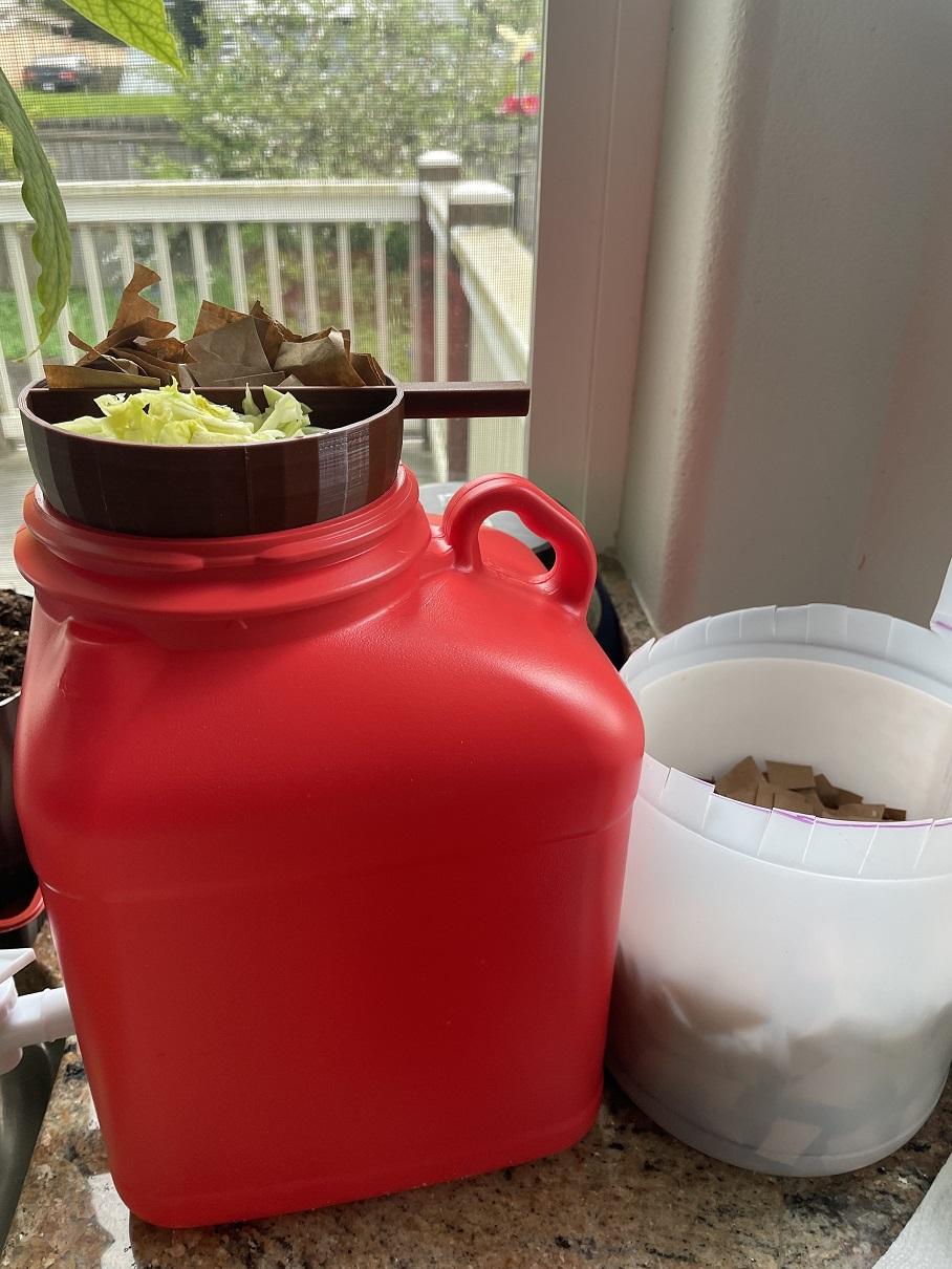

We ripped up some brown, unmarked paper bags to use as our brown waste, setting it in a jar next to the compost bin.
Now, we are ready to use our compost bin!
1.    Layer some brown waste at the bottom of the container.
2.    Place brown waste in one half of the spoon.
3.    As you work in the kitchen, collect the green waste and place it in the other half of the spoon.
4. Once both sides of the spoon are full, dump them into the bin and stir it a bit. Refill the brown waste side of the spoon.
5.    When the bin fills up, close the container lid and set the bin aside. It's time to start a new compost bin!

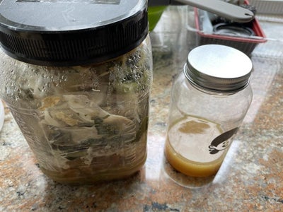

You should check on the full compost bins every once in a while to see if any liquid fertilizer has been produced yet. In our weather, I can typically start collecting liquid fertilizer in 2-3 weeks.
