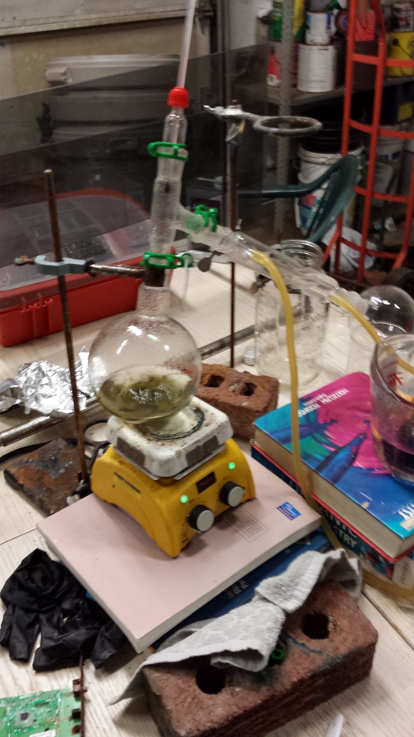

Here is a second purification with higher concentrations of acetone. The pH of the neutralized compounds is 7.5! The color is a bit more red due to the dissolving of the acetone into the st.john's wart hypericin and other molecules.

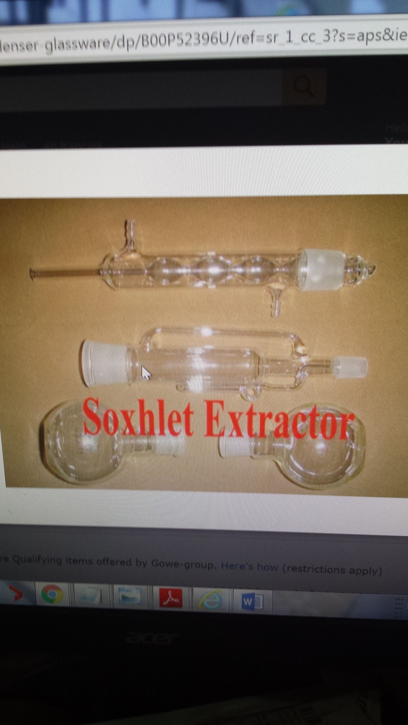

Here is a soxhlet distiller which would be better than extracting the st.john's wart compound since you dissolve the acetone in it and the extract naturally has no impurities. You add 50% acetone, 50% water and boil. The solution will dissolve the hypericin compounds and you can evaporate the acetone away.

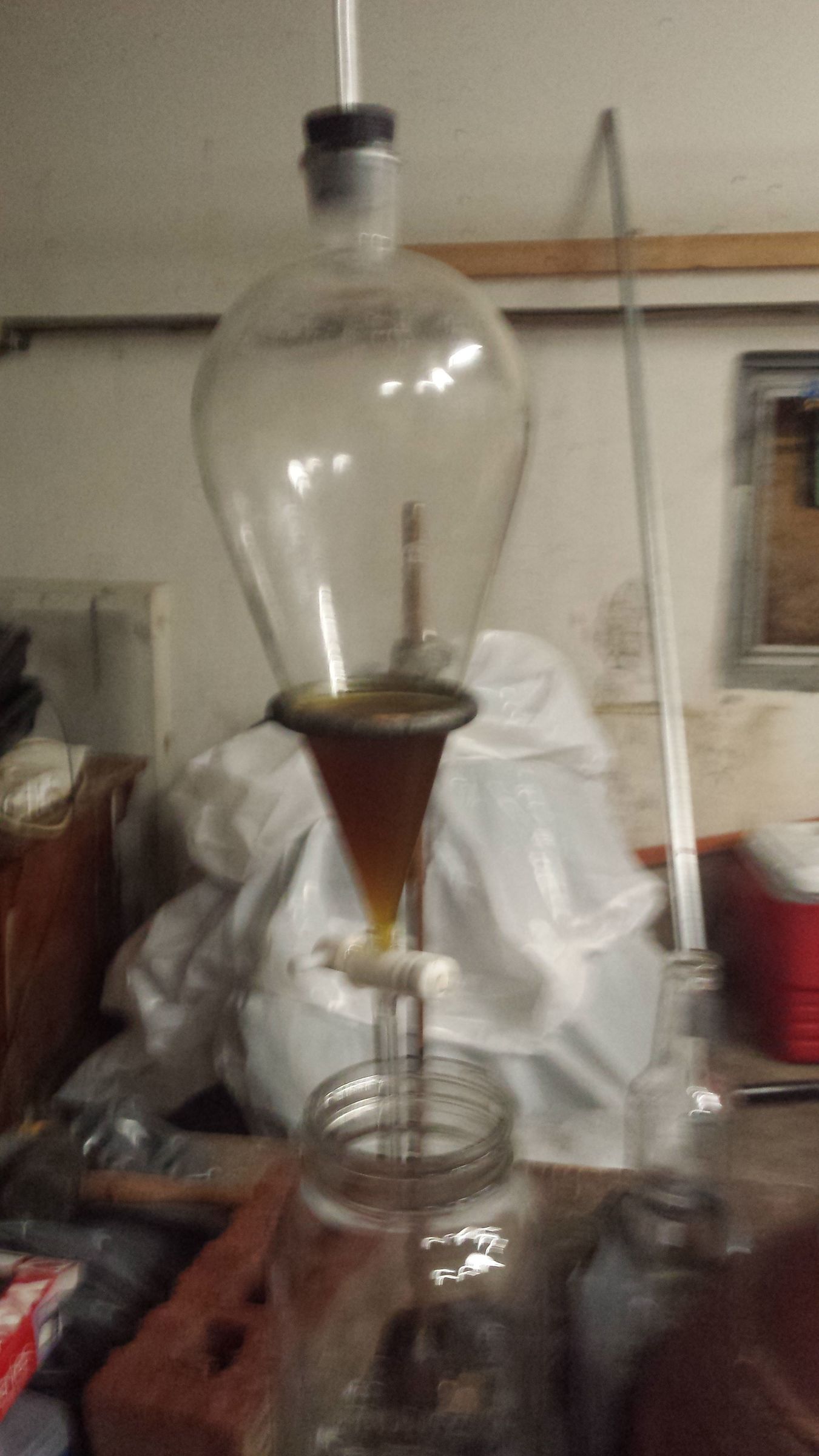

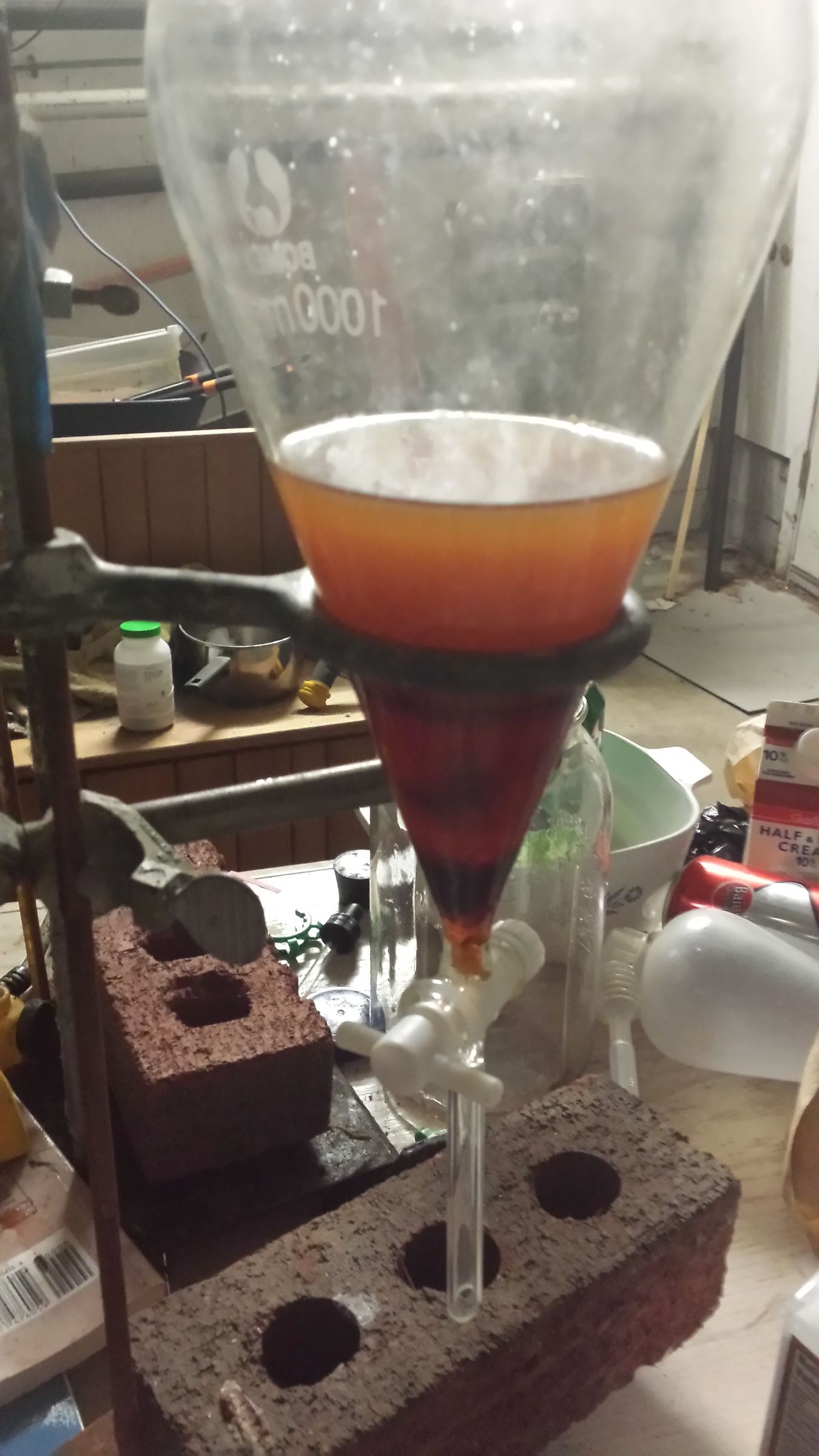

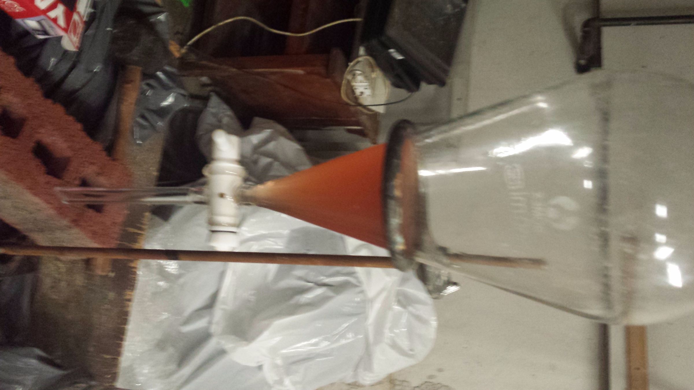

Here I separated some of the salt and I am allowing the acetone from the st.john's wart to evaporate off. It is done outside since acetone is FLAMMABLE.
6 years ago
Salt and acetone which are lighter than the heavy compounds forms a top (i think). Requires filtering and a second separation with gravity!
6 years ago
However the acetone caused some undissolved cell wall to solidify out of solution thus it was necessary to use cold acetone to extract the chloro hypericin compounds.

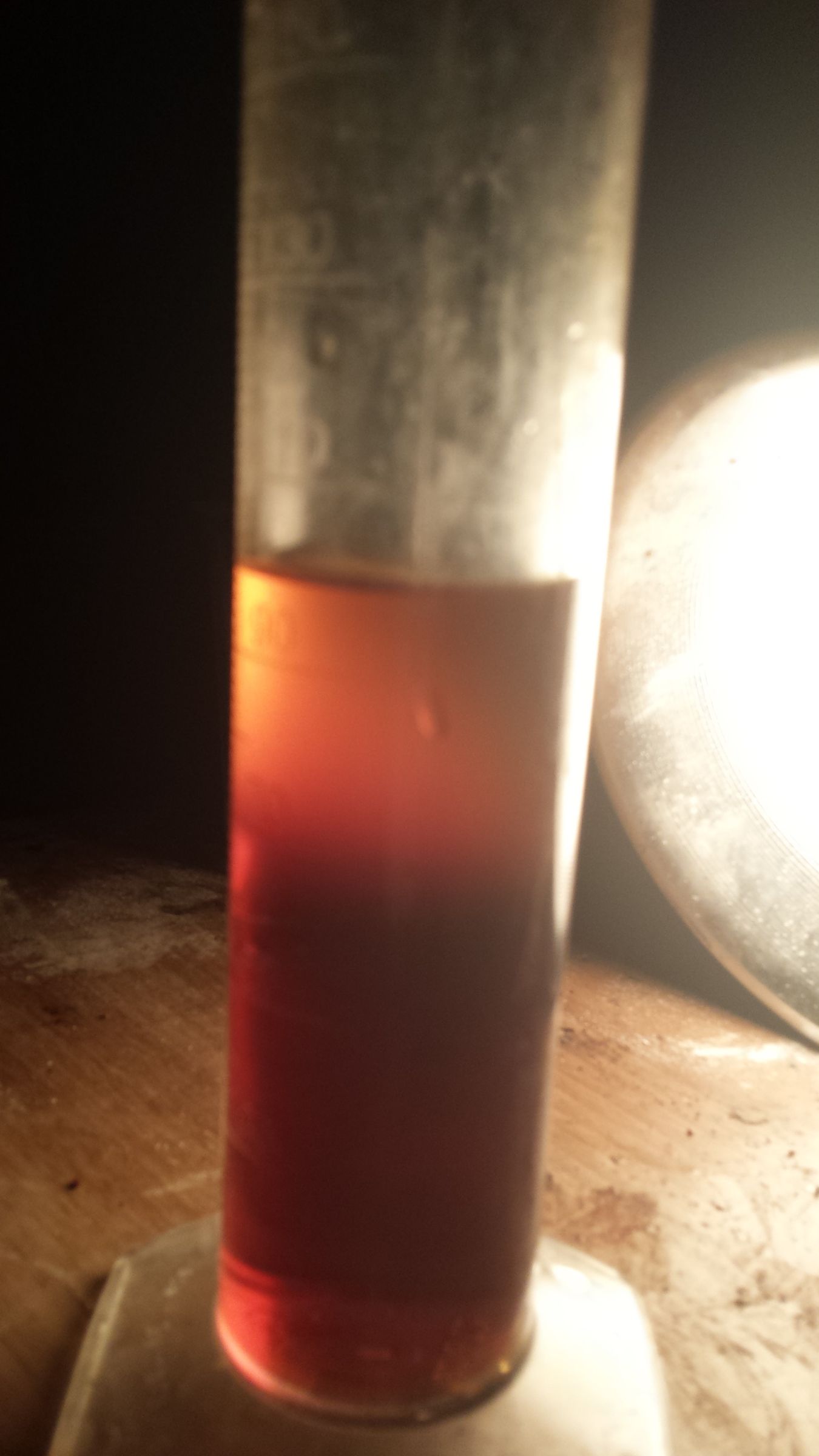

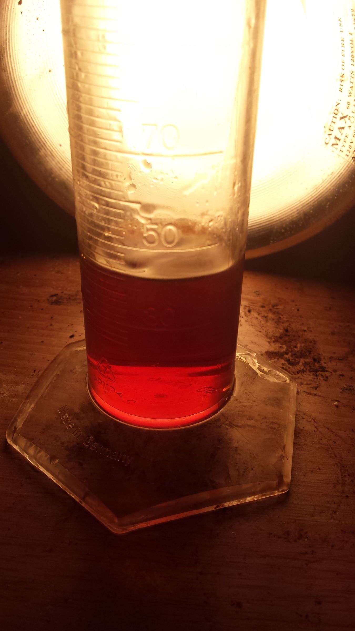

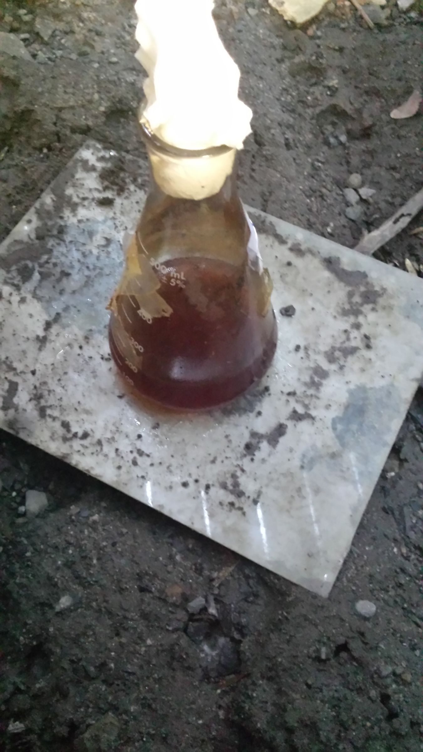

Here is the recovered sample with some bicarbonate removed. 50 ml of sample. Acetone barely dissolved the sodium carbonate with water.
6 years ago
Here is a picture when cold 8 degrees C acetone mixes with the st.john's wart mixture.

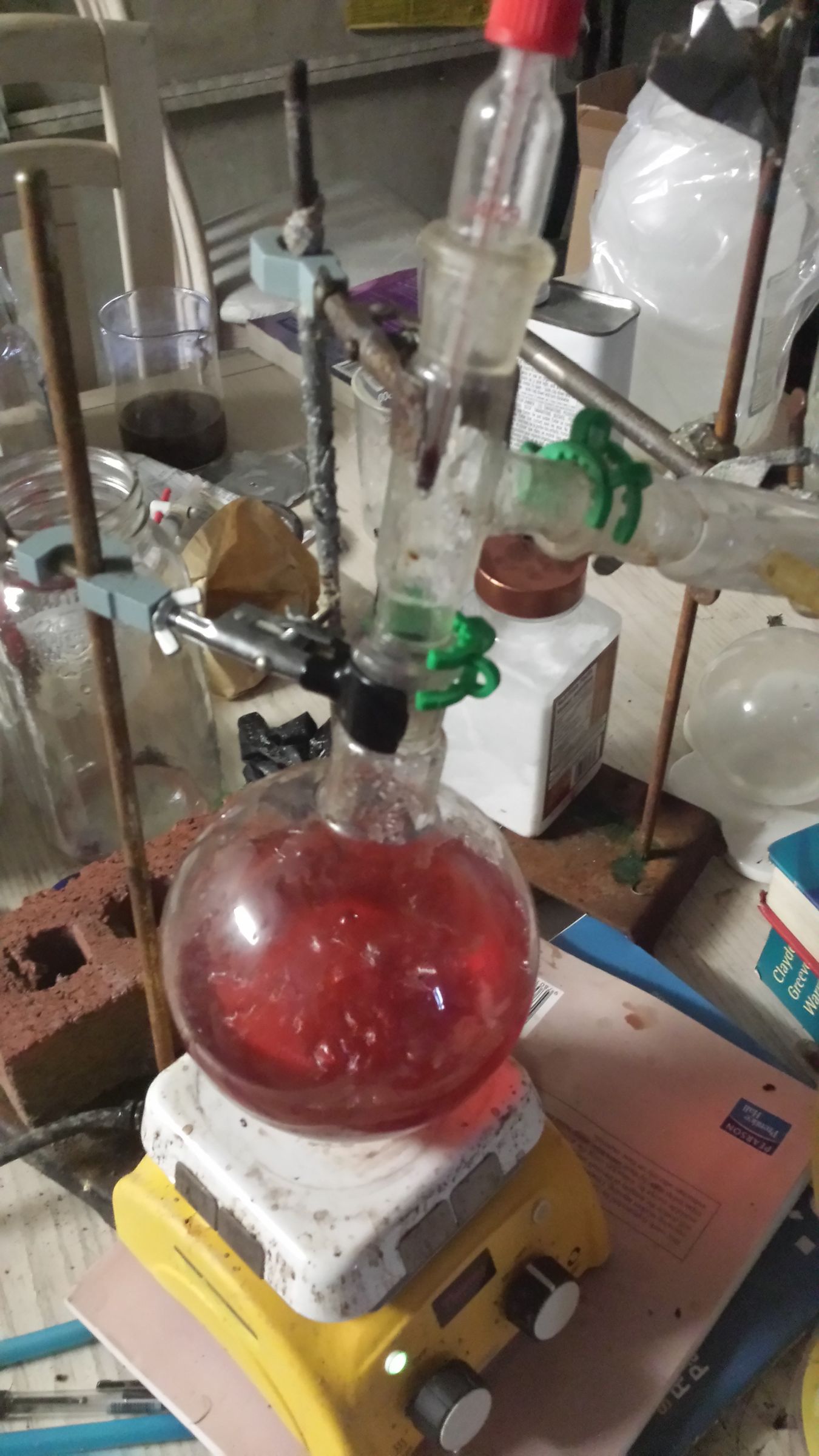

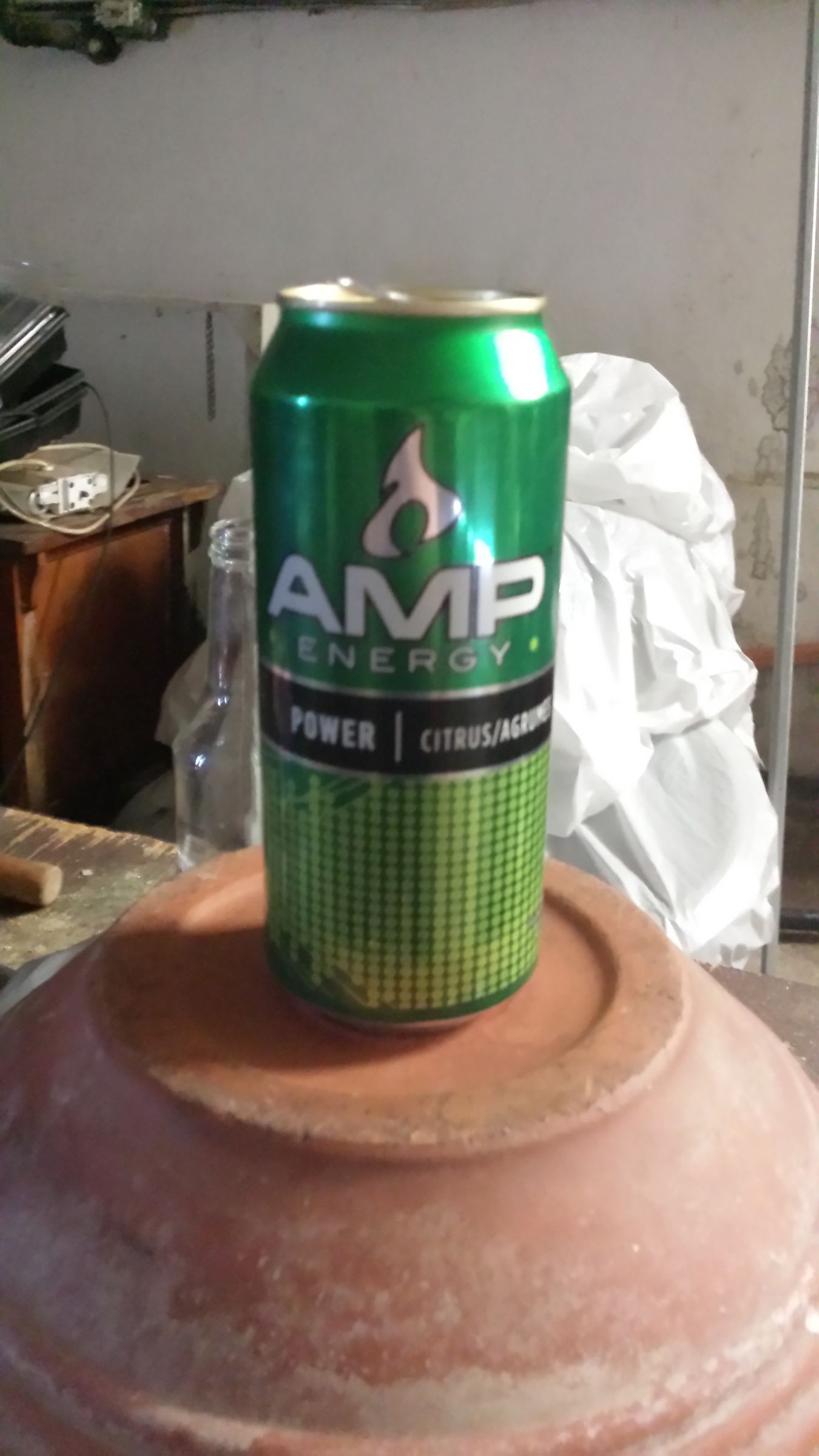

Here I am going to show what I can extract with 150 ml of cherry lemon 10% malt alc mixture with a lemon flavored energy drink filled up to 500 ml and boiling chips added. Lemon intense decayed odor can repel insects too.
6 years ago

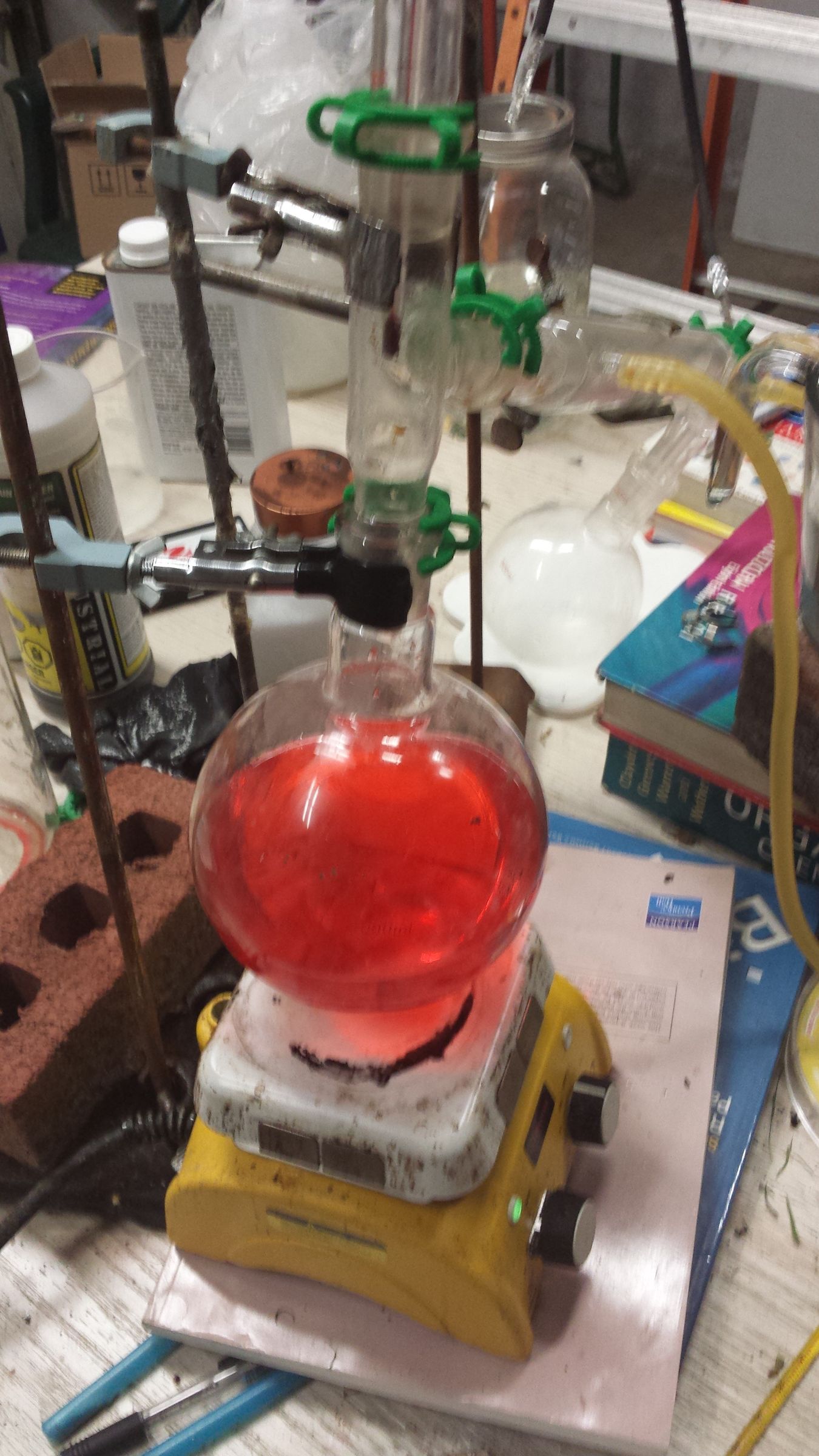

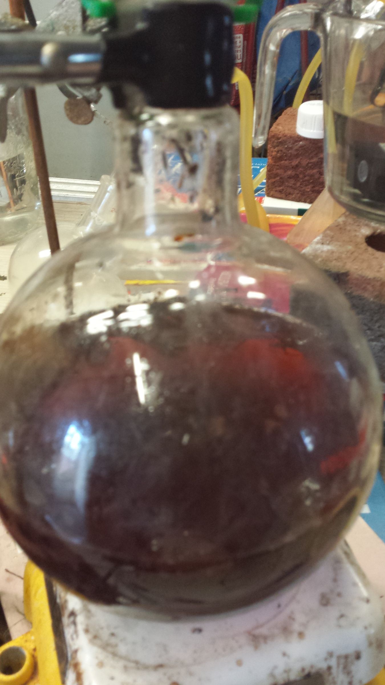

Here is a picture of a cherry-lemon guana energy drink alcohol 10% being distilled for the cherry odor.
6 years ago

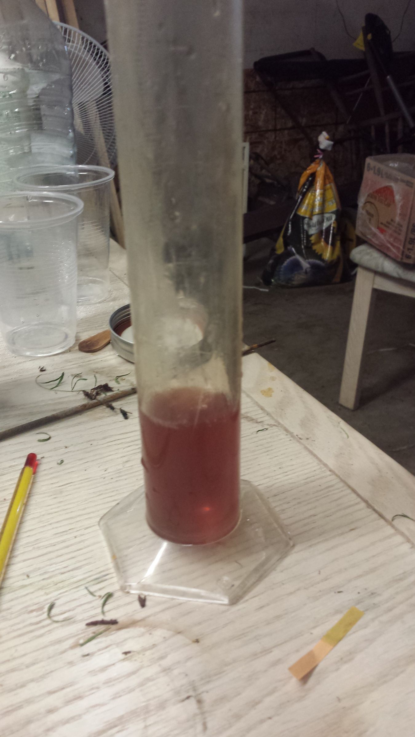

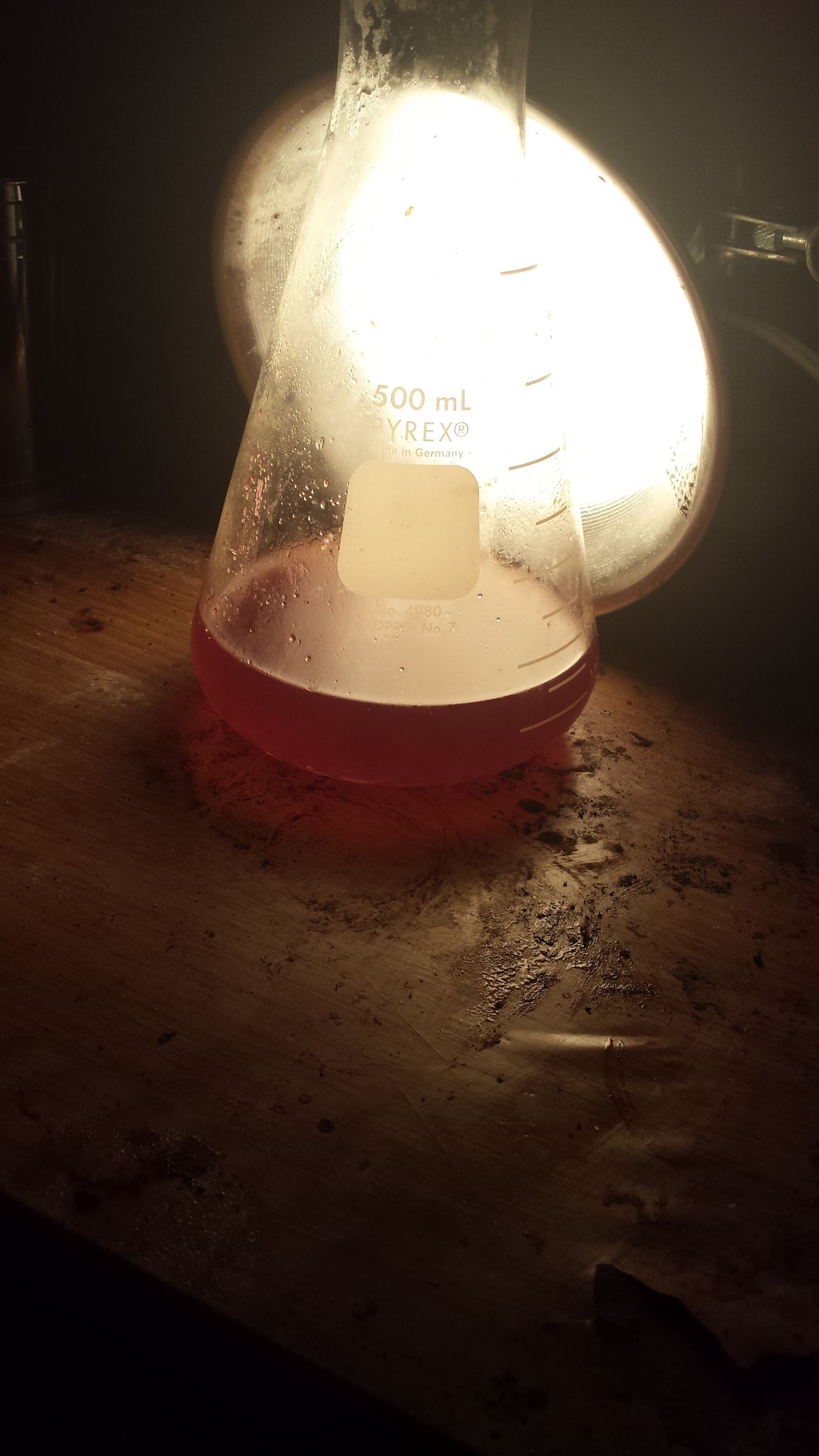

Here is at ph 7 what happens when ph of HCl initially 1 changes with 15 g of sodium carbonate. A salt (Sodium chloride) and different chloro hypericin are formed.
6 years ago
Since I used 100 ml of a extracted 360 mg of Hypericin and similar compounds for 400 ml the concentration of Hypericin is roughly 90 mg total. 5 ml of concentrated 25% Hydrochloric acid is added.
The color changed from light orange to light pink indicating a reaction with the following compounds with HCl (Anthraquinones).
