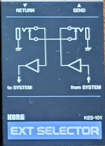

I am a PME40X user, and I like this multi effect very much. Sometimes I feel the need to place an external stompbox in my effects chain, but this is not possible without the external selector Korg realized for this pourpouse.
I have not one of these at hand, nor schematics unfortunately, but, as you can see, Korg placed some useful indication on the module front, soo...
.. let's go and realize a replacement for this!

The module in a nutshell is made of a pair of unity gain amplifiers, one at the input of the audio signal, the other in the return path. It uses a very small amount of cheap and common components, the op-amp being the "prom Queen", and obviously respects the PME40X modules pinout.
