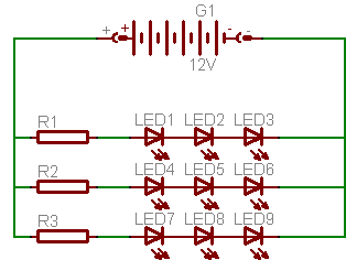

- 9x white special square type multi chip LEDs Very High Brightness ( I used 50,000 MCD 140* 100mA) I recommend these. They are what I used. $18 for 30.
- 3x 22 ohms (red red black) 1/2 watt resisters.

Solder LEDs in rows of 3. The Idea is to curve the LEDs joining the legs together wile the side of the LEDs are touching.
On these LEDs the positive anode is the strait leg. The negative cathode is the blade/heat sink fin thingy.

Step 4: Solder the Rows Together
Line them up so that they are side by side and solder the inner negatives together at the end.

Step 5: Attach Ground
Solder a piece of wire for the ground connecting all of the negatives of the LEDs
Step 6: Adding Power
Bend the end of the resister like as show in the picture and clip a part of the end leaving a little.
Clip off every other power connector on the first LED in each row.
Solder the bend end of the resister to the led keeping the resister as close to the LED as possible.
Twist the ends of the resister together with a piece of wire and solder together.
