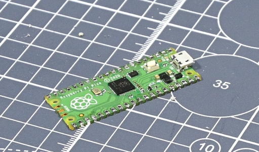

Step 8: Program the Pi Pico
Program the Pi Pico immediately. Due to the way that the Pico will be attached to the main PCB, it's really difficult to program it after it's been soldered down. So, grab the code from the attached file, and program the Pi Pico with it before you solder it down.
IMPORTANT!!
You need to use the Arduino-Pico library which can be installed through the instructions at this link. The official Arduino library that adds the Pi Pico will not work as it does not contain the AnalogWriteFreq(); function.

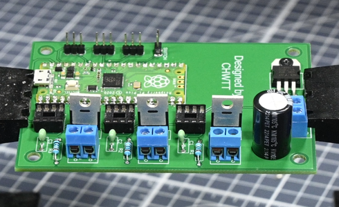

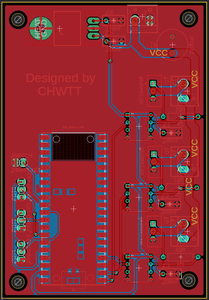

Step 9: Solder the Rest of the Board
Go ahead and solder the rest of the components to the PCB. Make sure that you get the MOSFETs the right way around, and the MOSFET drivers the right way around as well. Reference the provided Gerber view for information on the electrolytic capacitor's polarity placement.
With the "Designed by CHWTT" text facing you so that it's right side up, the upper left pin of each MOSFET driver IC is pin number 1 on the IC. Additionally, the backs of the MOSFETs themselves should face your right if you have the board oriented in this way (Shown in the Gerber view in the second image).

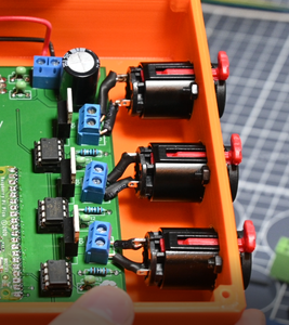

Step 10: Mount the Board to the Chassis As Well As the DC Jack and Switch
Mount the soldered PCB, the small rocker switch, and the DC barrel jack into your 3D printed enclosure. Wire them up so that the positive of the DC jack connects to one connection on the switch (If you're using a fuse make this connection with the fuse), then connect the other pole of the switch out to the power in on the PCB. Then take the ground from the DC jack and run that directly to the ground on the power in terminal of the PCB. For more details, watch the video.

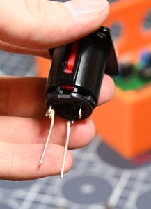

Step 11: Connect the Leads to the TS Connectors and Mount Them
Solder leads to the two terminals of the connectors that correspond to the T (Tip) and S (Sleeve) of the connectors we're using. Tip should be positive, and Sleeve should be ground. With the leads soldered, shape them so that they work seamlessly with the screw terminal blocks on the PCB when you insert them into the holes, they will be mounted in. I also recommend ensuring that the wires are nicely isolated, if you're using some bare solid core copper like I did in mine. The end result should look something like the third image, once you've used the included machine screws and nuts that came with the sockets to mount them to the chassis.

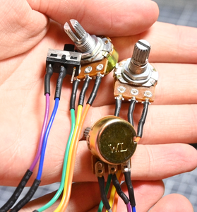

Step 12: Connect Leads to the Potentiometers and Switch
Connect some leads and some female 2.54MM headers to the potentiometers and the switch. These slide switches have a central common pin that either gets connected to the left pin or the right pin based on the position of the switch. We only need this switch to either connect or not connect the two leads that get connected to it, so solder one lead to the central pin of the switch and one lead to either the left or the right pin of the switch, it really doesn't matter which one.
The potentiometer's leads should be about 4 inches (10cm) long.
The switch's leads should be about 6-7 inches (15-17cm) long.

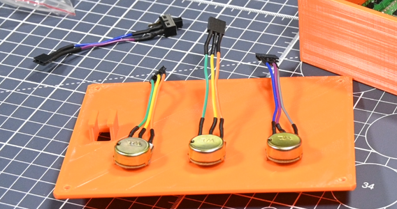

Step 13: Mount the Potentiometers and Switch to the Top Panel
When mounting the potentiometers, your potentiometers might have a little nub on them that is intended to penetrate the thing you're mounting it to disallow the body of the potentiometer from rotating. This nub will get in the way of our mounting, so either use a soldering iron to make a small divot in the lid piece for this nub to rest in (just be careful not to go out the other side!) or file off the nub.
When it comes to mounting the potentiometer, mount them so that the leads/pins are pointing towards the longer side of the lid, as shown in the picture.
The switch is intended to be glued into place in its small socket. Push it through from the front and then smother it in glue at the back. However, it's important to understand the orientation that the switch needs to be in. Because the switch kicks the controller into linked mode when it connects the two wires that are soldered to it, ensure that you orient the switch in a way that when its slider is on the side of the lid marked "Individual", the contacts are open, and when the switch's slider is pointing to the side of the lid that is marked "Linked", it's contacts are closed/connected.

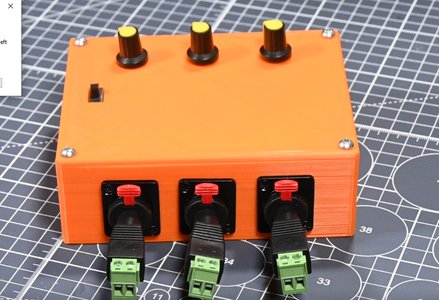

Step 14: Connect the Potentiometers and Switches to the Board and Attach Lid
With the device facing you as shown in the above image, that is, the TS connection jacks facing towards you, connect the potentiometer leads to the board so that the leftmost pins of the potentiometers are connected to the leftmost pins of the header for each potentiometer on the PCB. Basically, the wires should just go straight through from the potentiometer onto the board. This ensures that the potentiometers will increase the brightness of your lights when you turn them clockwise and decrease the brightness of the lights when you turn them counterclockwise. This is usually how adjustment knobs, such as volume knobs work, though if you wish to have your knobs adjust with opposite direction turns just flip the connections of the left and right pins of the potentiometer at the board. Make sure to keep the middle pin of the potentiometer in the center.
The switch can be connected to the board in any polarity, it won't affect it at all.
With everything plugged in, set the lid on the top of the box, align the screw holes, and screw it shut. You can also push the knobs on to the potentiometers at this point.
Step 15: Terminate Your Connections and Test Out Your Lights!
Finally, connect the LED panels to the TS ends so that the negative pole of the LED panel is connected to the S (Sleeve) terminal of the connector and the positive pole is connected to the T (Tip) terminal.
Now, you can plug in the AC adapter and your LED lights. Hopefully, if all went well, you should have a functioning lighting system. Have fun!
