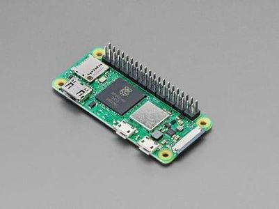

  1. 1x Raspberry Pi Zero 2W

  1. Insert the microSD card into your Raspberry Pi Zero 2W
  2. Connect power and wait ~2 minutes for first boot
  3. Find your Pi's IP address (check your router or use: ping dotnote.local)
  4. SSH into your Pi: ssh pi@[IP-ADDRESS] or ssh pi@dotnote.local

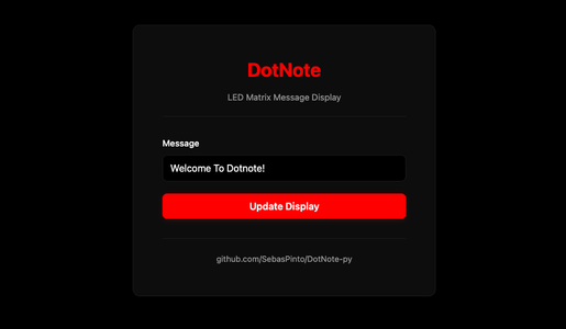

Test the display:
Your LED matrix should now show "Welcome to DotNote!" scrolling across.
Test the web interface:
1. Find your Pi's IP address: `hostname -I`
2. On another device (phone/computer) on the same network, open a browser
3. Go to: `http://[YOUR-PI-IP]:5000`
4. You should see the DotNote web interface
5. Type a message and click "Update Display"
6. Watch it scroll on your LED matrix!
If it works, press `Ctrl+C` to stop the server. We'll set it up to run automatically later.

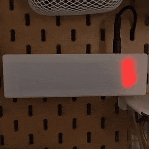

Step 7: Assemble the Case
What you need:
  1. 3D printed case parts
  2. Raspberry Pi Zero 2W (with software installed)
  3. MAX7219 LED Matrix
  4. 6x M2.5 screws
  5. Buzzer (optional)
  6. All wiring connected
Assembly steps:
  1. Place LED matrix into case bottom: The LED matrix should fit snugly in the designated slot
  2. Orient it so the LEDs face outward through the front opening
  3. Position Raspberry Pi Zero 2W: Place the Pi in its designated compartment
  4. Route cables
  5. Ensure all GPIO connections are secure
  6. Add buzzer (optional) Mount buzzer in the designated space
  7. Connect to GPIO 23 and GND
  8. Ensure no wires will be pinched when closing the case
  9. Attach top cover: Choose either Skadis mount or flat top
  10. Align screw posts carefully
  11. Insert 6x M2.5 screws and tighten gently
  12. Don't overtighten - PLA can crack!
Mounting options:
  1. Skadis Top: Hang on IKEA Skadis pegboard
  2. Flat Top: Place on desk or shelf

Step 10: Using DotNote
Web Interface:
  1. Open browser on any device on your network
  2. Go to: http://[YOUR-PI-IP]:5000
  3. Enter your message
  4. Click "Update Display"
  5. Watch it scroll!
