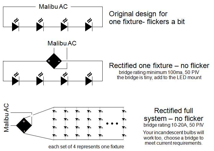

A while ago I decided to minimize our energy usage using LED lights wherever possible. Why not start in the front yard? I was using a 500 Watt supply and now use a 44 Watt supply! I looked online for Wedge Base LED Bulbs. I saw lots of fancy circuitry and weatherproof housings that were going into an enclosure on a regulated 12 Volt supply. They provided dim light and were not cheap! The cheap ones are a few dollars now. But you can make one for about 25 cents in materials. They also don't combine colors. We need to make a Wedge Base Bulb that will run comfortably on 12 Volts. This integrated circuit requires four components. In this case they will all be diodes, hehe.

Note: LEDs are diodes and as such allow current flow in only one direction. Current passes from the (+ long lead) Anode to the (- short lead) Cathode. The Cathode is also known as the Anvil. In this case the LEDs are connected in series and polarity must be observed. So basically the Leds must be joined at opposing leads for current to continue to flow through. Attach Anode to Cathode. Never wire two anodes or cathodes together. Even if you pay attention you will probably mess up at least one. No worries though, it's an easy fix. But not one you will want to repeat too many times, hehe.

You can also use different color LEDs that have a Voltage rating near that of a white LED. Colors with lower Voltage ratings can of course also be used. But I'm pretty sure the number of LEDs would have to increase to five. I posted resource links if you want investigate further. I made the RWB light below with Straw Hat LEDs for Red and Blue. Because they are what I had on hand. Straw Hat LEDs have a wider light dispersal and so are less focused. Great if you want something more moody. I finally went with a few white/blue bulbs near the entry among the sea of bluish white lights in the rest of the yard. One final thing. The lighting units you see here had three outer plastic rings. One is the lid. The other two slide over the lense. In these pics you can see that the center ring has been removed. This was to allow for maximum light to emit from the device and improve the visual quality of my new LED landscape lights! You might think, "This is gonna take forever!". But I did 16 bulbs in three nights while watching a movie. It was really very rewarding to change out that 500W transformer. Just remember to watch out for...
