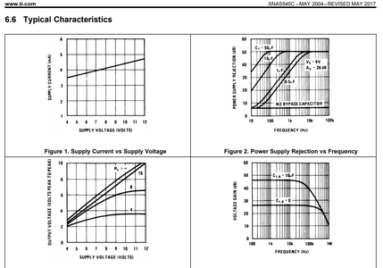

Firstly lets dive into electrical characteristics. It says, maximum power is obtainable (700mW max) at 8ohm load with supply as 9v. The Gain and PSRR can be varied.
The graphs in the 2nd image shows interesting details.
- First graph infers that ckt will consume only 4.5mA with 9v supply. thus it is battery friendly.
- Second graph says that PSRR value can be maximised by the use of a 47 uF capacitor at Pin7.
- Third graph says that at 9v, 8ohms, it will give a satisfactory performance.
- Fourth graph states that gain can be variable from 26dB(20) to 46dB(200), when pin 1 and 8 are bypassed by a 10uF capacitor.

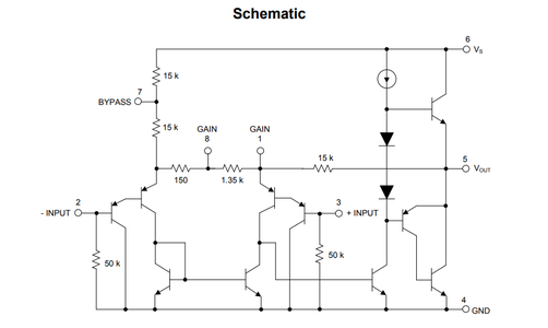

Datasheet says: To make the LM386 a more versatile amplifier, two pins (1 and 8) are provided for gain control. With pins 1 and 8 open the 1.35-kΩ resistor sets the gain at 20 (26 dB). If a capacitor is put from pin 1 to 8, bypassing the 1.35-kΩ resistor, the gain will go up to 200 (46 dB). If a resistor is placed in series with the capacitor, the gain can be set to any value from 20 to 200. Gain control can also be done by capacitively coupling a resistor (or FET) from pin 1 to ground.
Look out for the internal diagram at 4th image to get a more intuitive understanding.

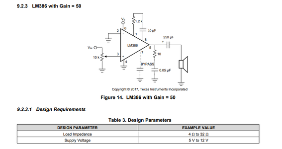

The third image shows an amplifier of fixed gain of 50. Now to make it variable a 10k pot can be used instead of that fixed 1.2K resistor across pin 1 and 8, in series with 10uF capacitor.

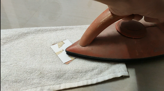

I will be using toner transfer method, the following steps to be done:
- Taking printout using Laser printer on a A4 glossy Photopaper ( mirrored, non inverted)
- Toner transfer using Cloth Iron

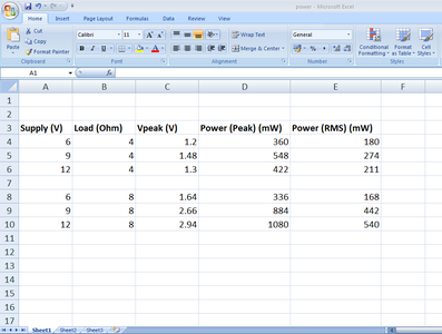

Step 9: Power Measurement

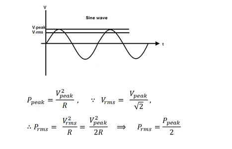

Power can be of two types:
- Peak power
- RMS power
When nothing is mentioned we take it as RMS power. To get the power measurement we need a DSO. The necessary process is as follows:
- Attach load (non inductive wire wound resistors is ideal for the job, but normal carbon resistors can be used in our case just for testing purposes).
- Set supply to a fixed voltage & power up circuit
- Use your smartphone as a signal generator and give a 1KHz sine signal to the input of the amplifier. (Android link: https://play.google.com/store/apps/details?id=com.keuwl.functiongenerator&hl=en_IN&gl=US )
- Attach DSO's probe to the load and observe signal.
- Adjust gain potentiometer such that the signal is amplified faithfully without any distortions and clipping. Set gain at the position such that beyond which the signal gets distorted.
- Measure Vpeak and apply formulas (images given) to measure Peak power and RMS power.
- Repeat the above steps for other voltage and load conditions.
Using these steps I have taken power measurements at several conditions, results shown in the images.
