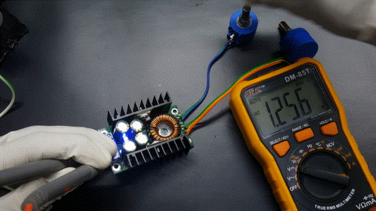

Step 1: Replacing the Pots

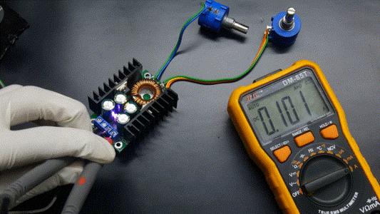

The first step is to remove the trimpots that come with the XL4016 module. I recommend setting your soldering iron's temperature to a higher value in order to get a brief and perfect desolder. Just keep the heated tip on the pads of the trimpots, add some solder and the pots would fall by their own. If not, you can also try pulling it gently.
After desoldering the two pots, I attached 2 wires for one potentiometer and 3 for the other. The reason is that the voltage adjustment section only uses 2 wires, and the third pad is directly connected by a small track to the middle pin.
But anyway, after hooking up the potentiometers to the XL4016 module, I tested it where both the adjustments worked flawlessly. I tried wiring them up only through trial and error method where I retry with another combination if it didn't work.
We also need to make sure that the wires don't come off easily due to the fact that the output voltage of the buck converter increases with an increase with the resistance of the connected potentiometer. Which means that if the potentiometer wire gets disconnected, the output voltage of the buck converter rises up to the maximum voltage, thus possibly killing whatever is connected to the output of the power supply.

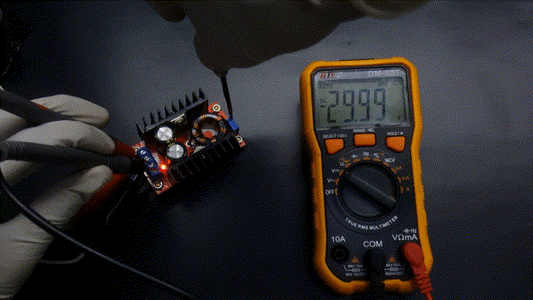

After wiring the pots, it was time to wire the boost converter module's output terminals to the input of the XL4016 module in order to achieve a wide voltage range. In my case, I felt like 30 V (28 V on output of the XL4016 module) is a good max limit voltage.
So, I hooked up my boost converter module to 12 V, connected my multimeter to the boost converter module's outputs and slowly adjusted the voltage adjustment trimpot till I hit 30.00 V in my multimeter.
If you need to, you can set the output voltage of the boost converter module to 34 or 35 V.
However, I do not really recommend this as the capacitors are rated for 35 V max, this implies that even a small spike on the output of the boost converter could easily damage the capacitor and thus the boost converter module. With 30 V, we have a 5 V headroom.

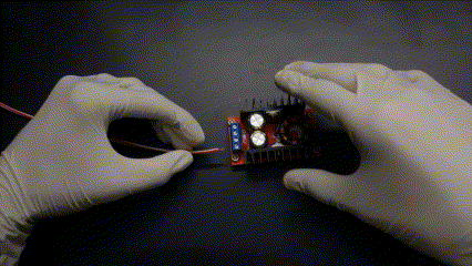

This is the step where you need to be very careful as a single wrong wiring might end up blowing up either of your modules. Hence, proper care and double-checking must be done when wiring these modules up.
With that, I started inserting the red wire into the Vout terminal of boost converter module, which is the positive output terminal followed by the black wire into the Gnd terminal in the output side.
I then connected those wires to the input terminals of my XL4016 buck converter module observing the correct polarity. A quick power on confirmed that my wiring was done right.

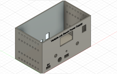

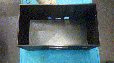

Like said, I have created a custom made enclosure which was designed in the Autodesk Fusion software.
It features all the necessary holes and cut-outs needed for the connectors, displays, switches and whatnot.
After 16 hours of slowly printing the case, I carefully removed all of the supports that were responsible to support the ventilation holes.

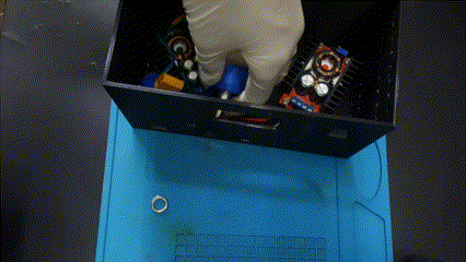

I then continued by first inserting the fuse holder, the switch and finally the male XT60 connector which was soldered with red and black wires beforehand.
Then I soldered the negative terminal to one of the terminals of the fuse holder and the positive terminal to one of the terminals of the switch.
I then used some hot glue in order to secure them firmly.
Up next, I carefully placed the buck converter as well as the boost converter module which were followed by the two potentiometers responsible for the voltage and constant current adjustment.
It is worth mentioning to use a small sheet of foam between the two modules for safety reasons.
Finally, it was time to tighten the bolts of the potentiometers onto the enclosure. This was followed by the knobs on the potentiometers.

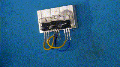

With that in place, I soldered the input pins of the voltage regulators together.
The 5 V regulator's output goes to the USB port, allowing us to charge our devices on the go. Just make sure to short the data pins (the two pins between the two voltage pins).
The 12 V regulator's output goes to the voltage current display whose thin red wire connects to the 12 V regulator's output while the yellow wire connects to the positive output of the step down converter. In this build, we ignore the thin black wire. Instead, we directly connect the thick black wire to the negative output terminal of the step down converter. This way, the display gets power, measures the voltage as well as the current values without interfering with the current limit function of the step down converter. The red thick wire carries the negative output of our step down converter. This red wire is directly connected to the negative pin of the T Deans connector.
The positive output of the step down converter is carried by a 1 square millimetre wire. This wire is directly soldered to one of the poles of the switch. The other pole of the switch is connected to the positive pin of the T Deans connector via a small 1 square millimetre wire.
Finally, the fan was connected directly to the output of the 24 V regulator via 2.54 mm headers.
