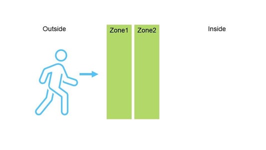

Counting people is not that different from counting objects. We just need to place two detectors in the heading direction of a person as seen in the first image. A detector can be any kind of sensor. For now we just need to know that we have two sensors and that each of them can tell us if a person is present or not. Each sensor checks in a zone, so we have zone 1 and zone 2 that can have a person inside them or not (true or false).
If a person goes from the inside to the outside, our sensors are going to detect it in zone 1, then in zone 2. Once the person has passed our sensors altogether (both sensors return false), we know that someone has entered the room. We then increase our count by one. If this person then decides to leave the room it is going to enter zone 2, then zone 1. If we look at the signals (image 3) you can see that we only need to check for the flanks on entering or leaving the detection zones. The table next to the graph shows all of the possible signal combinations and their counting result. The two lines at the bottom are people that stand in the doorway but then decide to go back so they are neither leaving nor entering (partial entry). I also made a little animation that shows the zone activation when a person enters and leaves the room (attached video).
So that's it, that is how you count people..... well there are some nuances. A simple people counter, such as the one that I am going to show you today, can only count one person at a time. If there were two people , passing our detection area at the same time, our people counter would get confused.

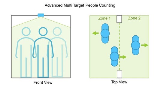

Multiple people going through the same door are pretty typical in places with wide doors, such as supermarkets. Here you would use a more advanced sensor system, such as a camera, that is mounted above the door (see image 4). Now through some image processing magic, you can detect the heads of people and analyze where they are going. This task is not trivial but can be achieved. Today we are going to focus on the simple counting mechanism and doors that are passed by one person at a time.

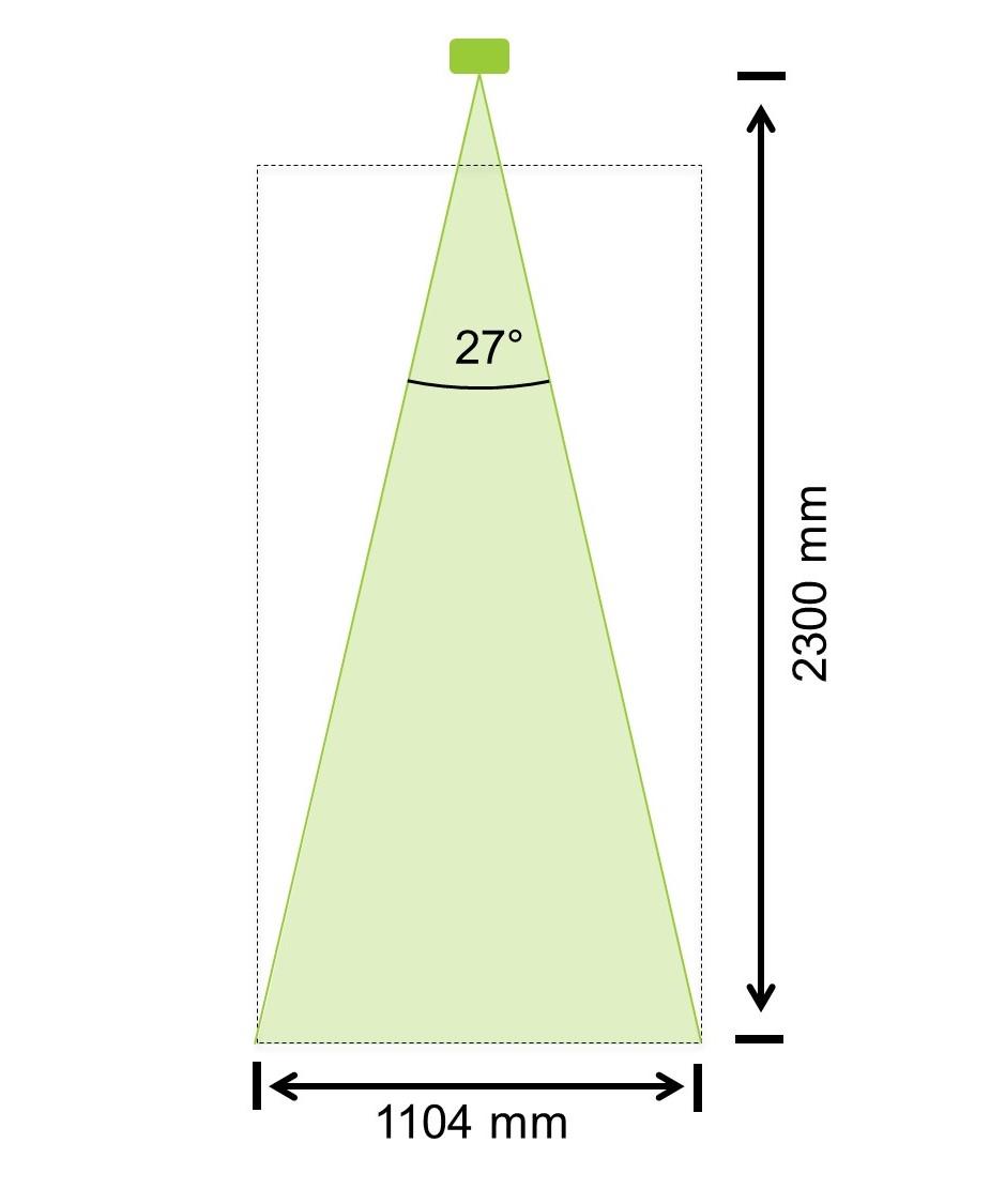

The sensor is essentially a very fast and very precise distance sensor. It uses the so called Time of Flight principle. I tried to visualize it in the second image. The Sensor consists of an emitter that emits a short pulse of laser lights. It waits for the light to bounce of a surface and return to the sensors receiver. Then it checks how long the light took to come back and uses a simple equation to calculate the distance to the object. It is actually very similar to an ultrasonic sensor, which uses the same equation with the speed of sound instead of the speed of light.
The sensor measures distances inside a cone-like shape (see the third image) with an opening angle of around 27 degrees. This angle is called the Field of View (FOV). However, the sensor does not have to look at the whole cone. The receiver of the VL53L1X is actually an array of 16x16 little light sensors (visualized in the third image). You can use software to tell it to only measure in a certain area of this array. This area is called a Region of Interest (ROI). By using this feature, we can split the cone which gives us two different zones. We can detect a person in each zone by checking if the measured distance is below a certain threshold. And if you read through the second step you already know that we can use this to count people.

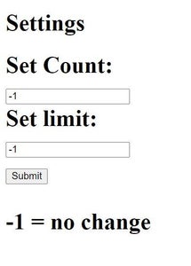

Before you mount the sensor you should verify that it is working and that you can connect to it. Assuming that you have done anything right in the previous steps you should just have to connect it to a USB power source and the people counter will establish a connection to your specified WiFi network. Next you will have to find it there and get its IP address. There are different ways to do this. You could use the Serial Monitor of the Arduino IDE to see the debugging output of the people counter or you could access your WiFi routers web interface and check which devices are in the network. I like to use a little smartphone app called "network utilities" which allows you to do an IP Scan in your local Network. If your smartphone and the counter are connected to the same WiFi network and your location services are turned on this should bring up an Espressif device (as seen in the first image). This device is your counter.
Copy the IP address, head over to your webbrowser of choice and enter it. It might take a couple of seconds but you should now see the web interface of the sensor (image 2).
