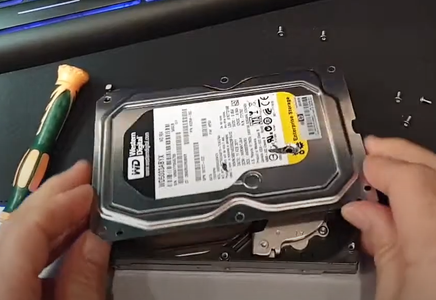

Two faulty hard drives from the well-known brand WD have been lying in the trash for a long time and taking up space.
And now the time has come to bring your old idea to life, to try to assemble a laser projector from them. Since the reading head of the HDD is nothing more than a galvanometer and it is just ideal for moving the mirror to a given position on one axis.
Step 1:
Armed with the tool, I begin to fulfill the intended goal. To do this, I first take apart the hard drives.

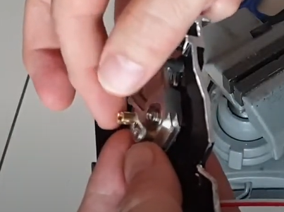

Next, I remove the head movement mechanism from it and remove the investment, magnetic pin.
Step 3:
Using a tester or visually, we find the contacts to which the conductors come from the electromagnetic coil and solder the wires to them.

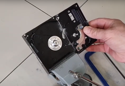

To reduce the size of the device, I saw the hard drive case in two.
