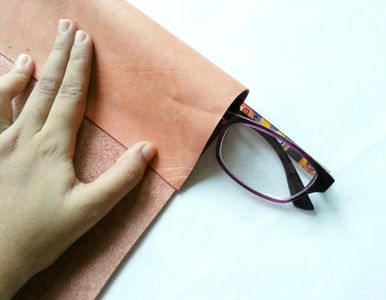

Step 2: Measureing and Cutting
Place the leather on a flat surface with its wrong side facing up. Place the glass on the wrong side of the leather.
Fold and wrap the leather around the glass once to measure the case size. Keep 2 cm extra on both open sides of the folded leather piece. Use a marker, chalk or pencil to trace along the sides of the leather.
Cut out the traced leather piece.Fold the leather piece into half width wise. Cut a round corner on any one of the open sides according to your glass size (see 2nd picture of this step).
