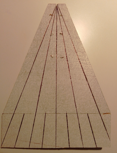

Step 1: Mark Out the Face
Carefully mark out your design using pencil on the plywood, either mark it out using a ruler and protractor or trace the plans using tracing paper.

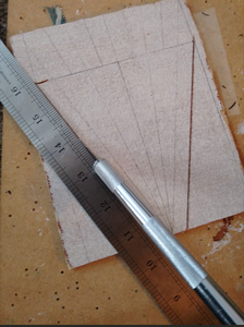

Step 2: Cut Out the Face
Carefully cut out the shape from the plywood using the cutting knife, cut along the line marking the exterior using a ruler to ensure a straight edge is cut. Gently cut multiple shallow cuts along the edge using the knife, until the level has been cut out. This will ensure that the level does not have any ragged edges. Cut a small notch (rectangular or v shaped) at the top of the level, as indicated on the plans. Wear impact resistant safety glasses and safety gloves to protect against injury at this stage.

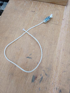

Step 5: Attach the String
Securely attach one end of the string to the plumb bob, then feed the string through the notch at the top of the level, secure the string in a position where the base of the plumb bob sits just above the base of the level. Securely stapple the string to the back of the level.
