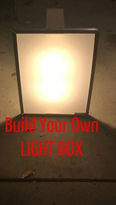

This project is about how to make a Light box for filming and picture taking.
Since this was prototype #1 the quality of the final product isn't the best and for prototype #2 I would change a lot. So I would recommend if you are thinking about making one of these learn form my project and make yours a bit more well thought out.

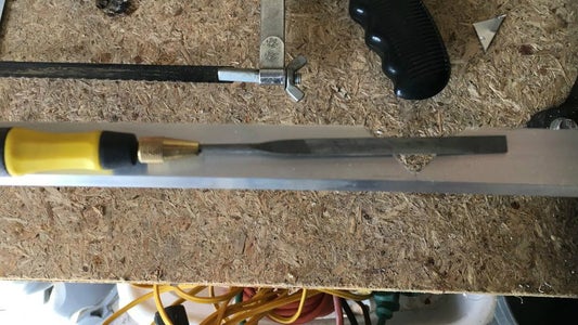

Step 2: Making a Frame With the Aluminum Angle
To help add structural support to the acrylic and to keep things looking somewhat nice we have to make an aluminum frame.
To do this we have to cut 2 45angle cuts on one side of the bar.
The best way I found to do this was to use a hand saw. Also the use of a file is recommend to remove sharp edges and blunt the corner a bit.
The larger side of the piece we are cutting out will face away from the other side of the bar. This way when we fold the bar it will create a right angle and an edge for the acrylic sheet to sit in.
When folding the bar I would recommend using an bench vice to get a clean fold.

Step 5: Plugging It In! & Final Thoughts
In real life the lights are a lot more diffused than in the picture. A lot of things are wrong in my design including the weights of the wood. The cost for me to build this project was $20 but I already had the acrylic.
Some changes I would make
- I would cover the back of the light with one of these emergency blankets, as it would help reflect the light to the diffused surface.
- I wouldn't use any wood, I would stick to making the entire project out of aluminum
- Add a attachment for a tripod, This can be done using a 1/4 in nut.
- Add more lights and use LED because they don't get hot.
Overall this was a simple yet effective project for taking videos and photos, the cost reflects the quality. Spending $20 more would drastically increase the quality of the light box.
