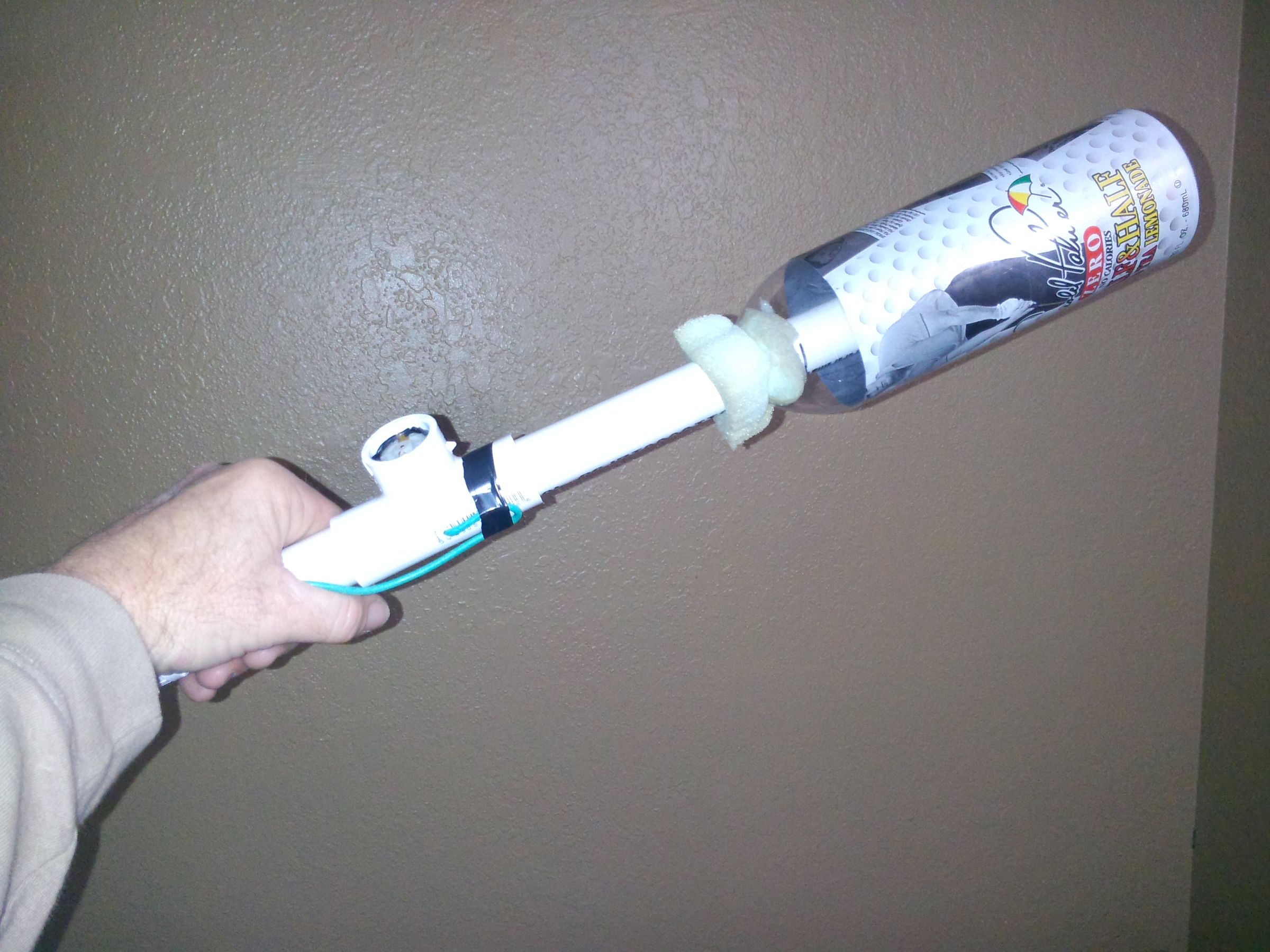

Introduction: DIY Lightning Wand -- a Handheld Van De Graaff Generator
Most instructions for building a Van de Graaff generator (VDG) are for tabletop models; however VDGs grounded through a person work well enough to make a handheld version possible. The Fun Fly Stick, a popular toy, is an example of a handheld VDG. This instructable will show you how to make your own handheld VDG capable of producing sparks up to an inch long with a few common items.

Step 2: Motor and Bottom Roller
The motor doesn't quite fit in the PVC Tee. Cut about 18 in of electrical tape; then cut this strip lengthwise. Now wrap the strips around the end of the motor closest to the terminals. Add or remove bits of tape until the motor fits.
To create the bottom roller, cut a narrow strip of polyvinyl chloride electrical tape and wrap it around the motor's shaft. The best way to get the tape to wrap around the shaft is by pinching the tape to the shaft and rolling it between your thumb and index finger. You also want to crown the roller (make it thicker in the middle) by pulling your index finger slightly to the right for a couple turns then pushing back to the left for a couple more turns repeatedly as you roll on the tape. A crowned roller will keep the rubber band from slipping off the roller. Add a bit of super glue to the end of the tape strip to prevent it from unrolling, also add a little super glue to the edge of the roller to bind all the layers of tape together. I tried making rollers out of Teflon tape and silicone rubber, both of which are lower on the triboelectric series, but a roller made from electrical tape was easiest to work with. I did not know what material the generic black electrical tape I had was made from, so to be positive the bottom roller was vinyl electrical tape I used blue 3M 35, but 33+ should work well too.

Step 6: Complete Assembly
Loop the rubber band onto the upper roller and insert the roller assembly into its holes. Thread an alligator lead through the column, hook the rubber band, and pull it through the column. Pinch a loop into the end of the rubber band and hook it onto the lower roller. Insert the column into the Tee. Look down into the column to make sure the rubber band is not twisted and everything is lined up. Point the upper comb at the rubber band. Make sure neither comb is touching the rubber band. Place the aluminum can onto the column. Push the support up until the can rests on it. Use a couple pieces of electrical tape to affix the can to the support. Later you can glue the bottle neck to the can, but make sure the hole in the bottle is large enough to pass the PVC with the upper wire attached. The end of the upper comb's wire should make contact with the inside of the aluminum can. Place a 3/4" PVC cap onto the handle and insert it into the Tee. Grip the end of the lower comb's wire (aka ground wire) while holding the handle. Apply power to the motor. With a lot of luck you'll feel a static charge on the collector when you move your hand near.
To prevent the VDG from producing sparks you can cover the collector with a piece of cardboard. The VDG will still perform most of the same stunts including the merciless destruction of electronic devices.
