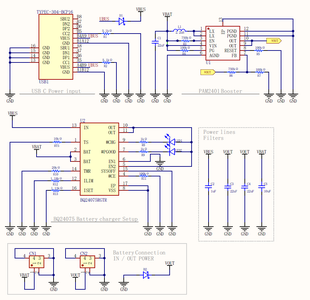

Circuit schematic showing charger and booster ICs
Schematic Tips
  1. Isolate power paths! My mistake: Accidentally connecting charger/booster outputs (more in Step 4).

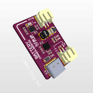

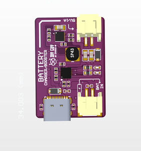

  1. Size: 24mm × 34mm (fits behind a battery)
  2. Ground Plane: Full copper pour under power components
  3. Component Placement:Inductor <5mm from PAM2401 (reduces noise)
  4. USB-C port on left edge for easy access

  1. Root Cause:
  2. My schematic accidentally connected the charger and booster outputs!
