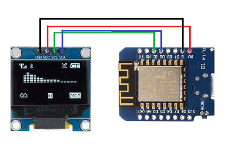

Step 1: Wiring the Components
To make everything work we need to wire everything.
You can follow the image diagram or use this:
G = GND
5V = VDD
D1 = SCK
D2 = SDA
You can solder the cables afterwards to make it compact but this is for testing if it works.

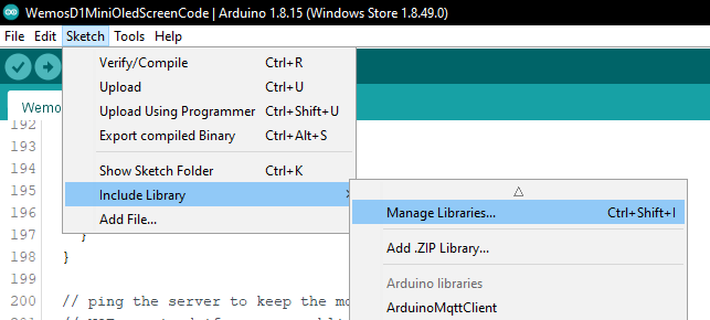

Step 2: Setting Up the Libraries.
First we need to download the Adafruit SSD1306 library.
1. So we're going to go to Sketch>Include library>Manage Libraries.
2. Search 'SSD1306' and select Select Version and click version 1.3.0 and install.
3. Search GFX and select Select Version and click version 1.5.6 and install.
4. Search Mqtt and install ArduinoMqttClient and Adafruit MQTT Library.

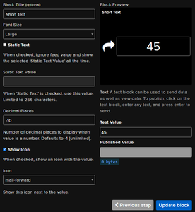

Then we'll need to make a profile on https://io.adafruit.com/
When you made your profile you can make a dashboard.
Press New Dashboard if you're in the dashboard menu, name it for example "MessageDashboard" and make the key that name as well.
In the dashboard add a new block and name the feed ShortText and in the settings change it to the settings in the given image. (NOTE: Make sure u call the feed name exact the same as given, otherwise it won't work.)
Next make a block called LongText and in the settings change it to the settings in the given image but change the name to LongText. (NOTE: Make sure u call the feed name exact the same as given, otherwise it won't work.)
When that's done go to the "My key" tab on the top and copy your key in the "#define AIO_KEY "xxxx" " and change the #define AIO_USERNAME "xxxx" to the username you made.

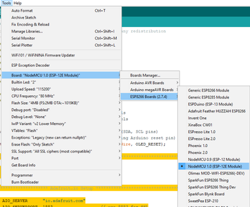

If that confirms your code is good then we can upload the code. You can do that by first plugging your Wemos D1 mini in your pc with a Micro-USB cable. Then going to Tools> Board> ESP8266 Boards> NodeMCU 1.0 (ES{-12E Module). And then select a port and the port is probably the second one but if u don't see it, use another cable or try using this tutorial to install the Wemos D1 mini drivers Tutorial for Wemos D1 mini Drivers.
When u have selected the right board and port you can upload it! (The right facing arrow next to the verify button)
