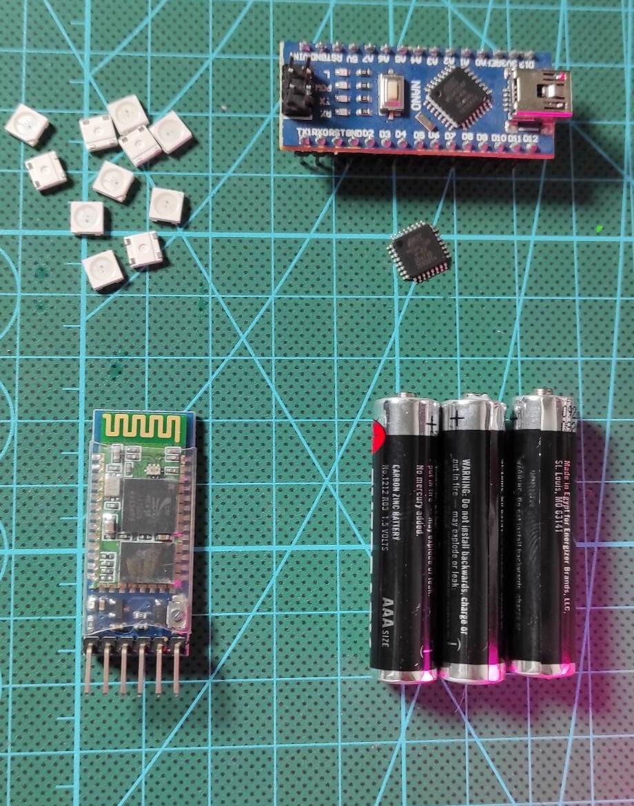

  • AVR Atmega328p with Arduino Bootloader (similar to the MCU of Arduino Nano board)
  • WS2812B Addressable RGB LEDs (42 LEDs)
  • Power source (3 rechargeable batteries)
  • Bluetooth module
  • Altium Designer software
  • CH340 USB to TTL converter
  • USB C connector
  • 3D printer
  • White mat plexiglass
  • Android phone with Bluetooth capabilities

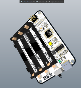

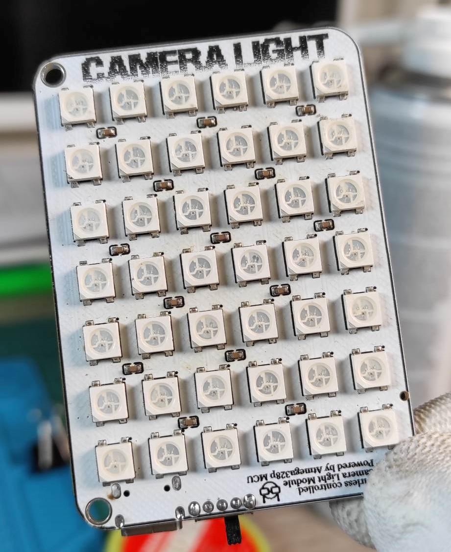

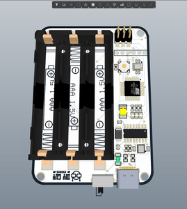

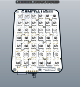

Once you have gathered all the required components, you can start designing the circuit using software like Altium Designer. Start by arranging the LED pixels in a 7 by 6 matrix, and ensure each LED has a 100nF bypass capacitor. Place the microcontroller and its necessary crystal, USB data line, batteries bracket, and Bluetooth connector in the design.
Step 2: Ordering and Assembling

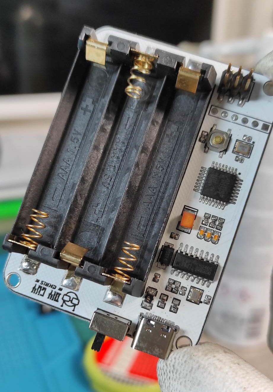

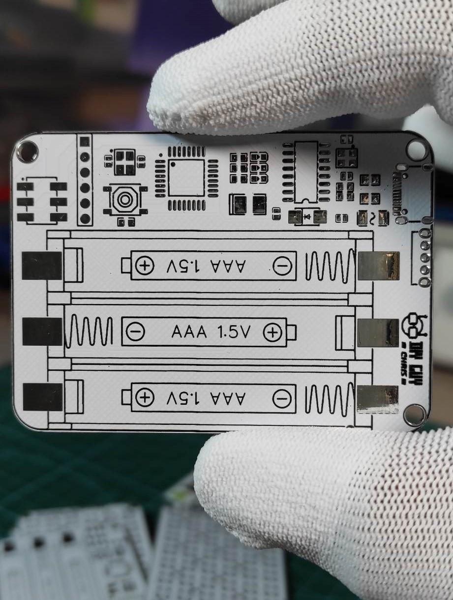

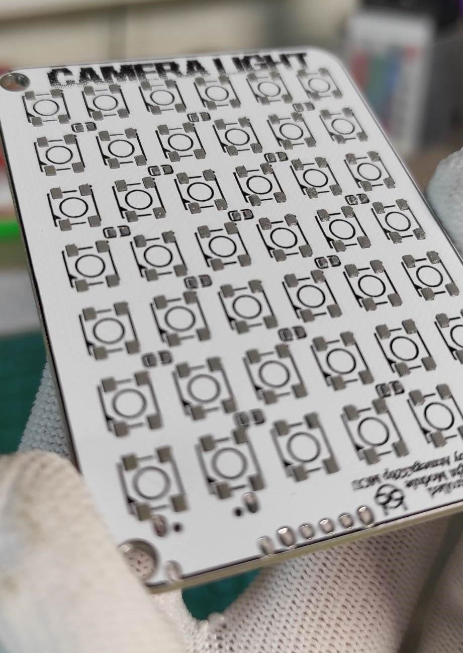

After designing the circuit, you can export the Gerber files and upload them to a PCB manufacturer like JLCPCB to place a PCB order. Make sure to order the top and bottom stencil to help with board assembly. Once the PCBs are delivered, use the stencil to deposit solder paste on the top side of the board and place the bypass capacitors and RGB LED pixels. Use a hot plate to complete the assembly, then clean the board with flux removal solvent.
Next, repeat the process for the bottom side of the board, except use a low-temperature profile solder paste to keep the top side components connected. Reflow the bottom side of the board using a hot air soldering station. Solder the Bluetooth module and ensure to set a customized Bluetooth name to identify the device.

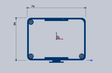

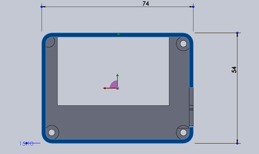

To complete the device assembly, design the top and bottom covers using a 3D printer. Use 3mm threaded inserts to assemble the device housing, and attach a white mat plexiglass screen to the top side of the gadget.

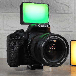

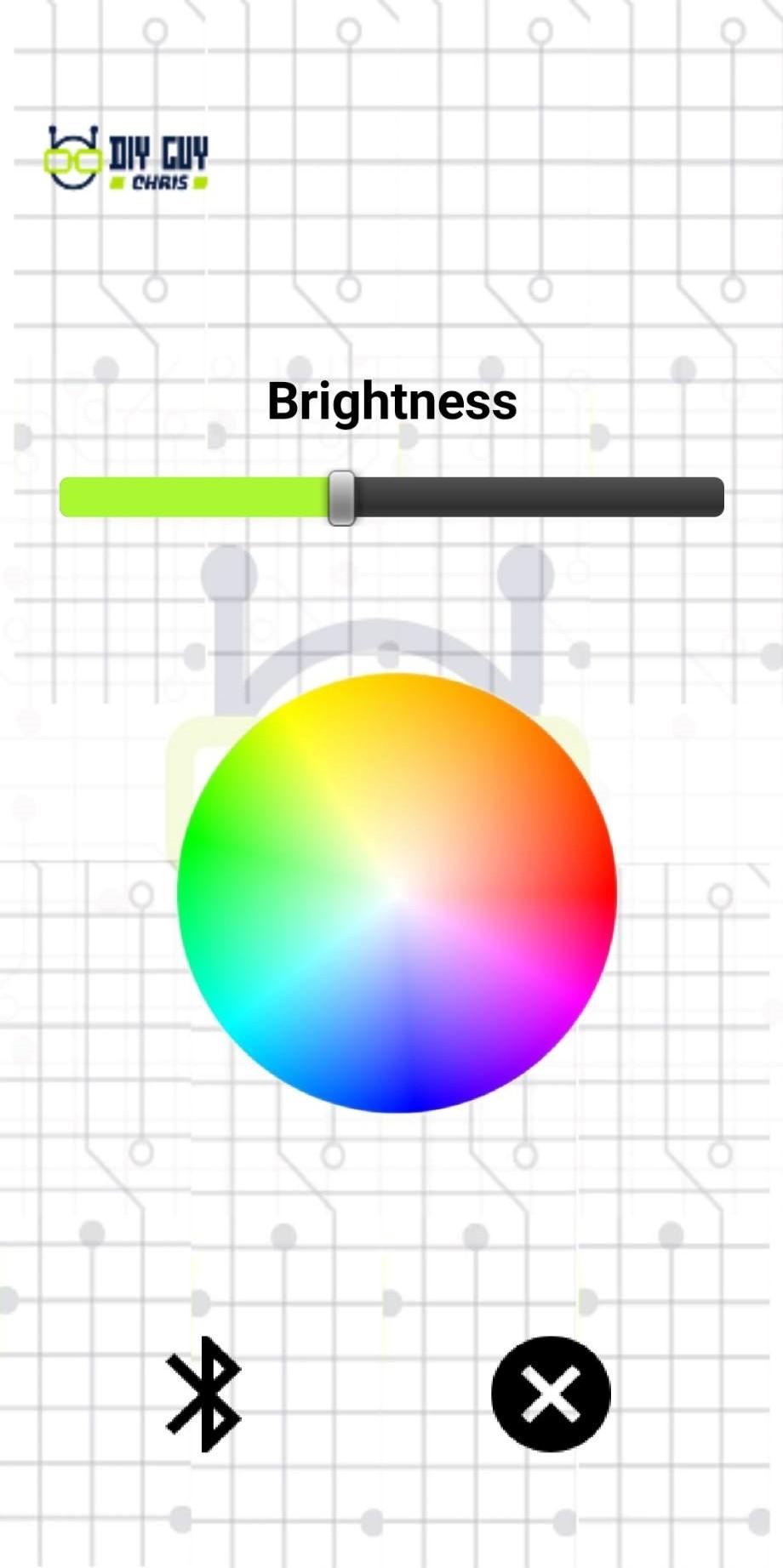

Lastly, create an Android app to control the color and brightness of the camera light using a color palette and slider. Connect the phone to the camera light using Bluetooth, and you're ready to start taking amazing photos and videos!
