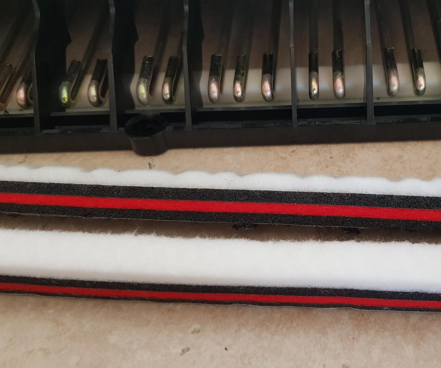

Step 4: Hair Dryer Nichrome Wire
You just have to cut a 50cm wire length
and unbend it manually.

I place
Step 7:
Be careful to center the wire in the middle of the U
Be careful to level the wire just below the surface: it should never touch directly the plastic sheet!
