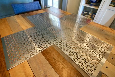

Design a X shape using your desired height, width, and depth dimensions and use that shape to decide what size metal sheeting you will need.
It will need to be the size of 2x the height + the width in one direction and 2x the height + the depth in the other direction.
Our bins are 12″x12″x12″ so they needed to be 36″x36″ metal sheets.
