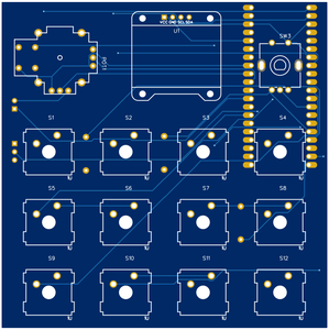

Step 3: PCB Design
In this project, I've engineered a custom PCB (Printed Circuit Board) that simplifies the assembly process. The advantage of creating a unique PCB design allows us to skip the usual wiring process usually required. By customizing our PCB, we've inherently streamlined the assembly process to be quicker and more efficient.

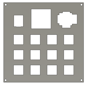

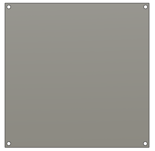

Step 6: Enclosure Design
The enclosure was made in Fusion360. The enclosure consist of top and bottom part which will be fixed to the PCB through M3 Brass HEX standoffs and screws. Download the STL file here.
