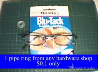

There are all you will need:
1) Blu Tack (very little), about $0.1 buck
2) A pair of Presbyopia glass(must use 250 to 275 degrees) get one at 1 dollar Shop
3) 1 piece of pipe ring form any DIY shop, about $0.1 buck

Step 1: Tools We Need

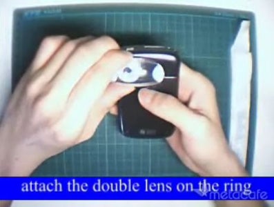

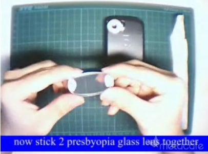

Step 2: Remove the Lens
you will need 2 lens from the glass

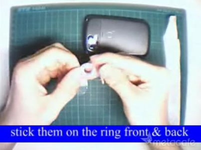

Step 3: Add Blu Tack
attach some blu tack on the ring (front and back)
Step 4: Add Blu Tack on Lens
add some blu tack in between the lens (left and right), don't block the center

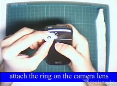

Step 5: Attach Them on the Camera
attach them on the camera
