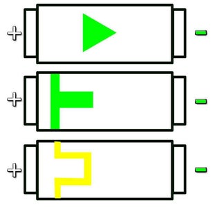

You may have noticed I started with the IC first, I DO NOT RECOMMEND THIS, you'll understand later. Soldering the led and the resistor should be easy as cake. Put some solder on the pad and move either the LED or the resistor in place and tack one side down. Then you can move onto the other side. The resistors have no orientation, but the LEDs do! Observe the pictures for guidance. In my pictures, the green dot on the top signifies the negative terminal.

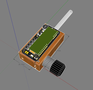

This can be a little difficult. I initially designed the board so that the buck converter would fit right on top of the male pins, but the pins on the buck converter were very difficult to remove so I went with this option instead.
The buck converter pins will form a 90-degree angle with the pins on the board. I tried bending the last pins in each set in order to "lock in" the buck converter so it wouldn't move while soldering it. I highly recommend adding solder flux to the connections; it will make the soldering experience much less frustrating. Once soldered, snip the excess pins.

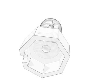

Step 10: Step 9: 3D Printed Battery Case
You will need to cut the wood nail you've acquired. The nail head will need to be cut till its about 35-36mm long, then the remaining nail will be cut down to a 30mm segment. The remaining nail can be recycled. Grind off the burrs and grind the top of the nail head so you have somewhere to solder. Grind the nail head so that the head looks more like a D, this will help later with spacing.
Turn your iron up as you'll need the heat. Apply solder flux to the top of the nail head and apply some solder until it sticks. Attach the positive wire to the middle rod and the negative wire to the smooth rod. Do the same for the other segment of the nail, but keep in mind that you will need to solder to the top of the nail otherwise it will not fit into the case!
Apply some liquid electrical tape to the top of the smooth nail around the solder joint and a few mm below. Reason for this is that the nail head and the smooth nail come uncomfortably close together. Better though it to grind down a portion of the nail head... I'll add that to the top.
Everything should fit perfectly in the casing, apply some superglue and make sure the rods stick.
Printing the Battery Case:
NOTE: The attached stl may not have a deep enough grove for some models and may require some slight modifications. I recommend a dry fit first and if the rod protrudes too much, scrape out some of the plastic in the print until it fits like a glove!
I'm currently selling assembled versions of these if you would like to buy them. Otherwise, the stl files are attached. I used a Stratasys Mojo to print mine. I cannot say how these will print with other 3D printers.
