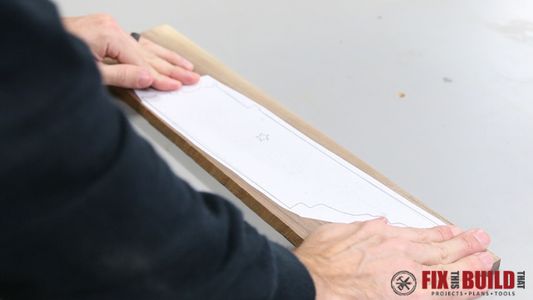

I printed out a Tennessee state shape from http://www.coloringcastle.com/state_coloring_pages.html (I resized it in PowerPoint). Then I used some spray adhesive and stuck it to the wood.
Using my bandsaw I cut out around the template lines. You can also do this with a jigsaw or scroll saw. Remove the template when done and you have your rough shape.

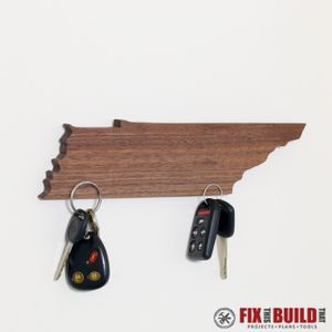

That's it, your all done! Just toss your keys up and watch the magnets snatch them.
