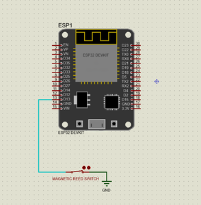

Step 1: Wiring the Magnetic Reed Switch
Connect the Esp32 and Sensor according to the connection Diagram.
polarity doesn't matter.
