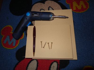

You will need:
-16x 1-1/4" screws

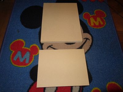

The size of the base of my KRK RoKit 5 G2 is 18,5cm x 23 cm, then:

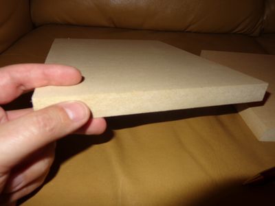

Base and Tops (I choose MDF instead Wood):
- 4 x 1,8cm x 19,5cm x 25cm MDF (just a little bit wider...)
Legs:
-4 x 1,8cm x 15cm x 20cm MDF
Others:

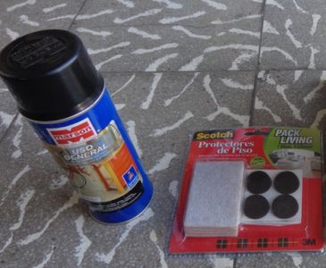

-1 Spray paint
- 8 felt pads (4 on each base)

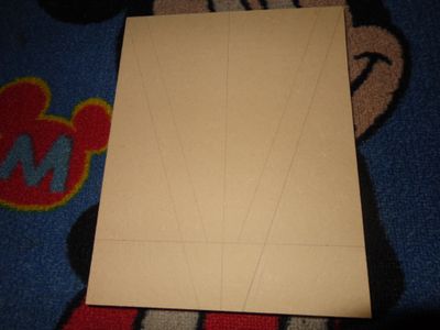

Step 2: Legs in Perfect Angle..

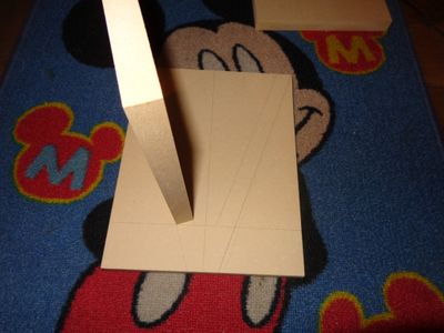

Before you begin, you must measure the dimensions of your speaker. For the base, I recommend increase 1cm at sides and 5cm back .
Cut the MDF or apply in specialized store. MDF is very cheap. For this project spent only $ 2.50
I decided to leave the base and the top of the same size ( I think it only worth leaving base larger if the legs are higher than 12 ").

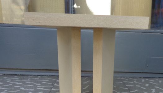

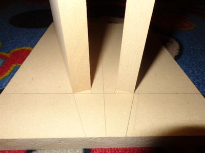

With a pencil I marked the location of the 2 legs, in angle, with a small gap (you can also try to put them together , making a 45 ° cut at the edges ), also marked the location of the 4 screws.

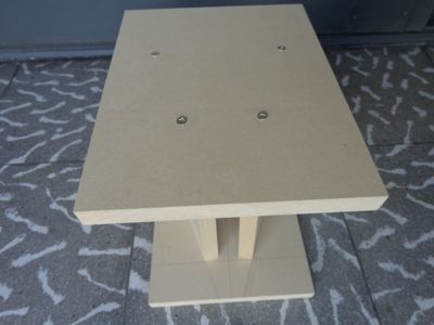

Step 3: Preparing the Surface
Drill the base and top before assembling.
After drilling the 4 screws , cleaned the zone with a knife or similar, to clean the remains and obtain a flat surface.
Step 4: ​Assembling
Start screwing legs to the top first, then the base. Making sure to place the legs in the lines drawn at the base or top .

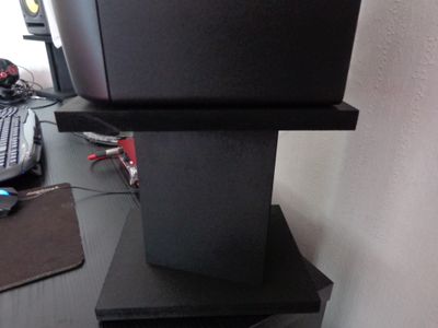

Tighten the screws leaving exactly at the level of the surface or even rather a little inside, so do not touch or the floor or the speakers. Wipe clean with a cloth the dust residues.

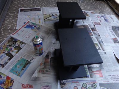

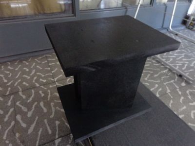

Step 5: Painting
Sweep the can across the project, about 20 cm away uniformly. beginning and ending each coat off the side. Complete a coat over the entire project at one time, instead of working in stages. This will give you more consistent color and finish.
The initial coat should be dry within a couple of hours.
The second coat of finish quality looks great. Even you can give a third hand and get better.

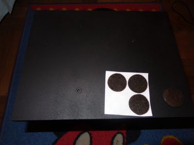

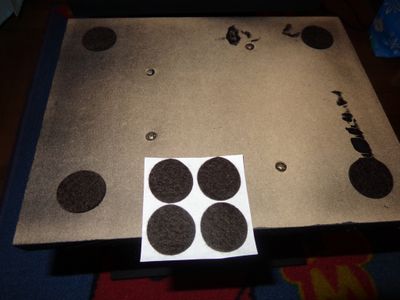

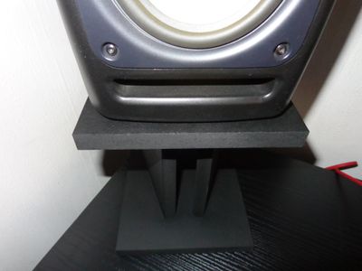

Finally stick the 4 pads to the base.
Now let's go to the Next Step to see My Gallery !!! -->

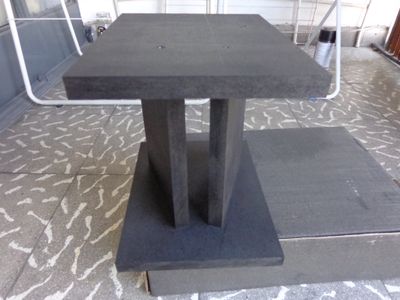

Step 6: Gallery and Lessons Learned:
Here is the new look of my desk !!!... The sound is substantially enhanced...
  • The MDF is like a sponge , so it is highly advisable to paint a first coat of sealer or latex for our first coat of paint . which will grant quality to our first coat of paint.
  • If MDF cut has some saw marks ensure to sand the sides before painting.
  • If wood is used, could use varnish to highlight the texture of the wood...
