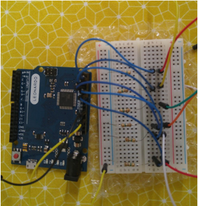

Step 2: Wiring
The image below shows the wiring that is needed for one key of your makey-makey-like device. In order to obtain 6 functional keys, you will need to repeat this wiring 6 times overall, each time using a different analog pin on your arduino leonardo.
