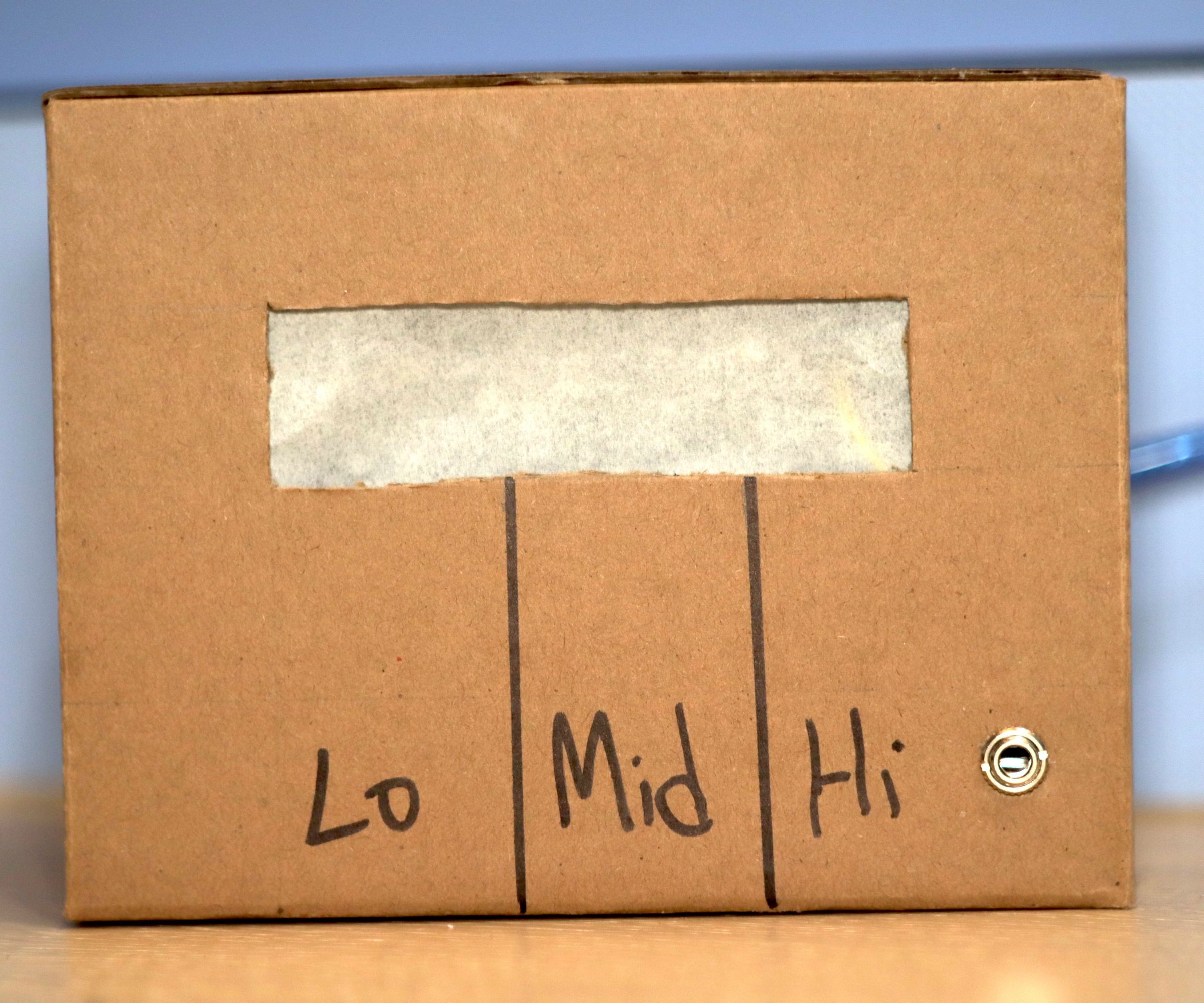

Step 5: Bonus Step: Make It Pretty
This extra step will make your DIY makey makey look more professional and more easily used. First Prepare some cardboard boxes, some aluminum foils, a few paper fasteners, and duct tapes.
1. Put your makey makey into the box.
2. Cut out necessary holes to leave the contact wires exposed.
3. Use a small strip of duct tape to create a ring, then stick a paper fastener to it.
4. Cut out small circular holes on the top of the box, to create a 2 by 3 hole pattern.
5. Cover cardboard pieces with aluminum foils and connect a paper fastener under it.
6. Connect the other end of the configuration, A0-A3, to each aluminum foil pieces' paper fastener.
7. You're finished!
Now you have finished the basic steps for your makey makey to be modular. Switch out different ways to place your aluminum foil pieces for a different experience.
